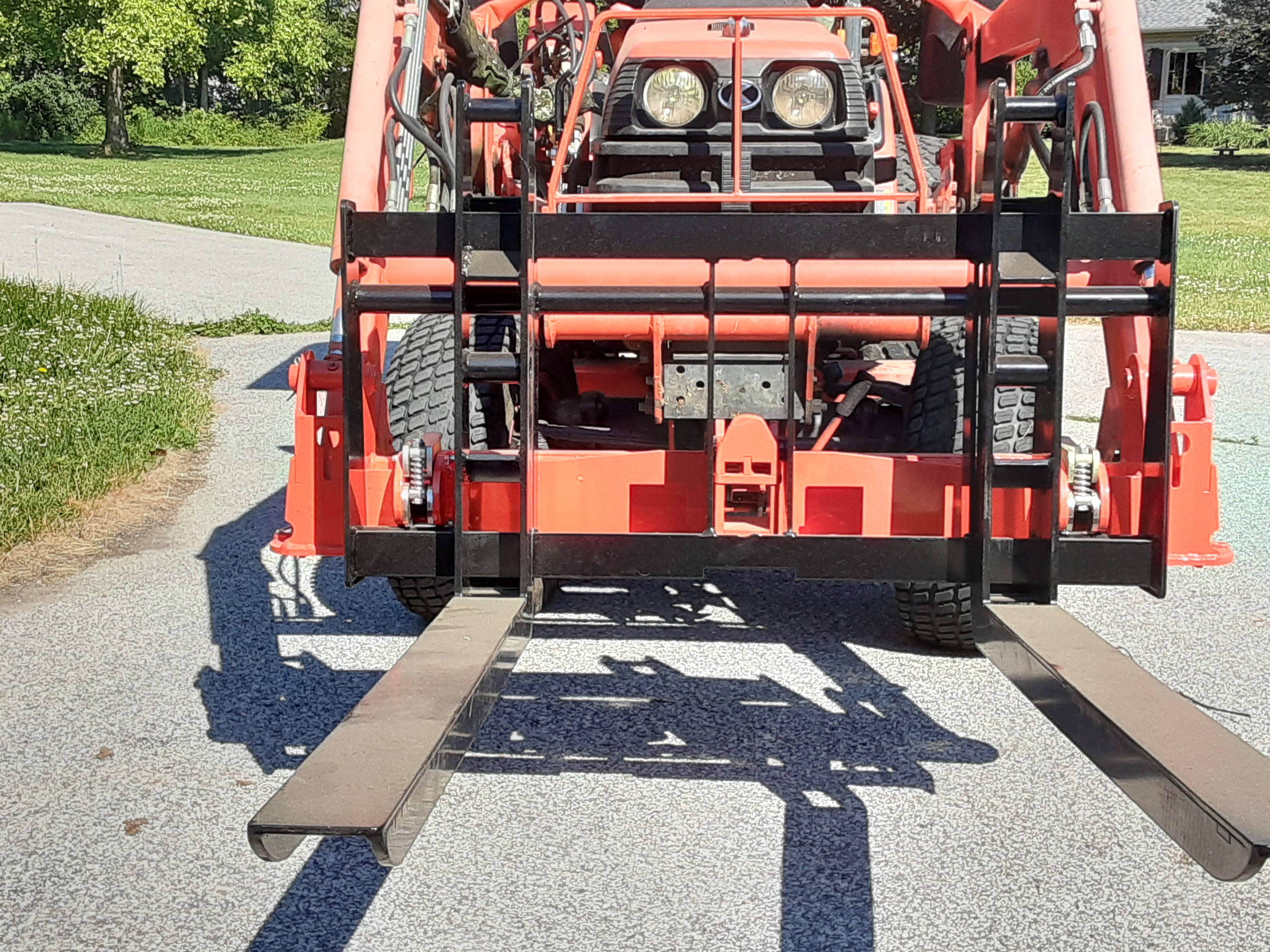

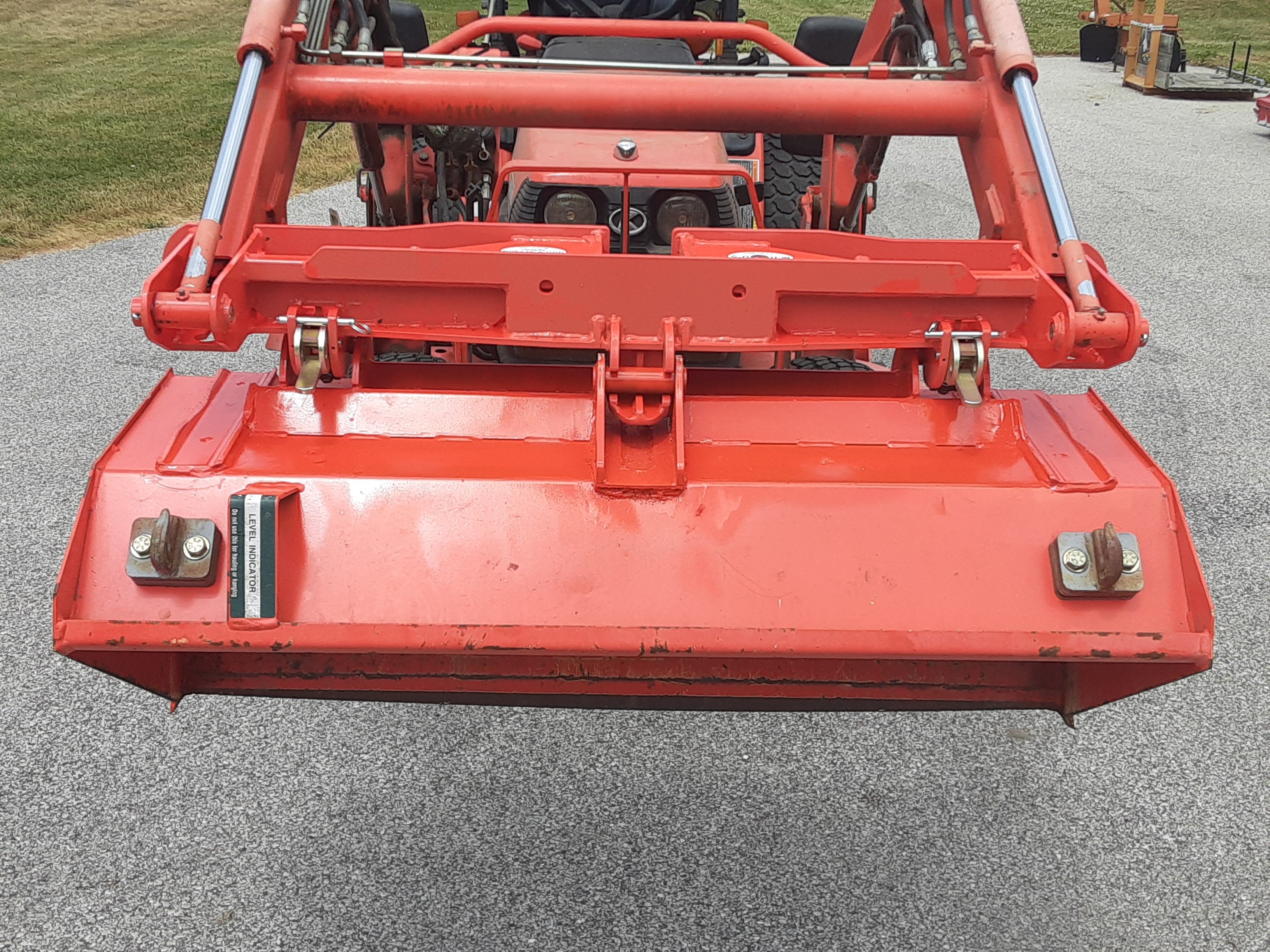

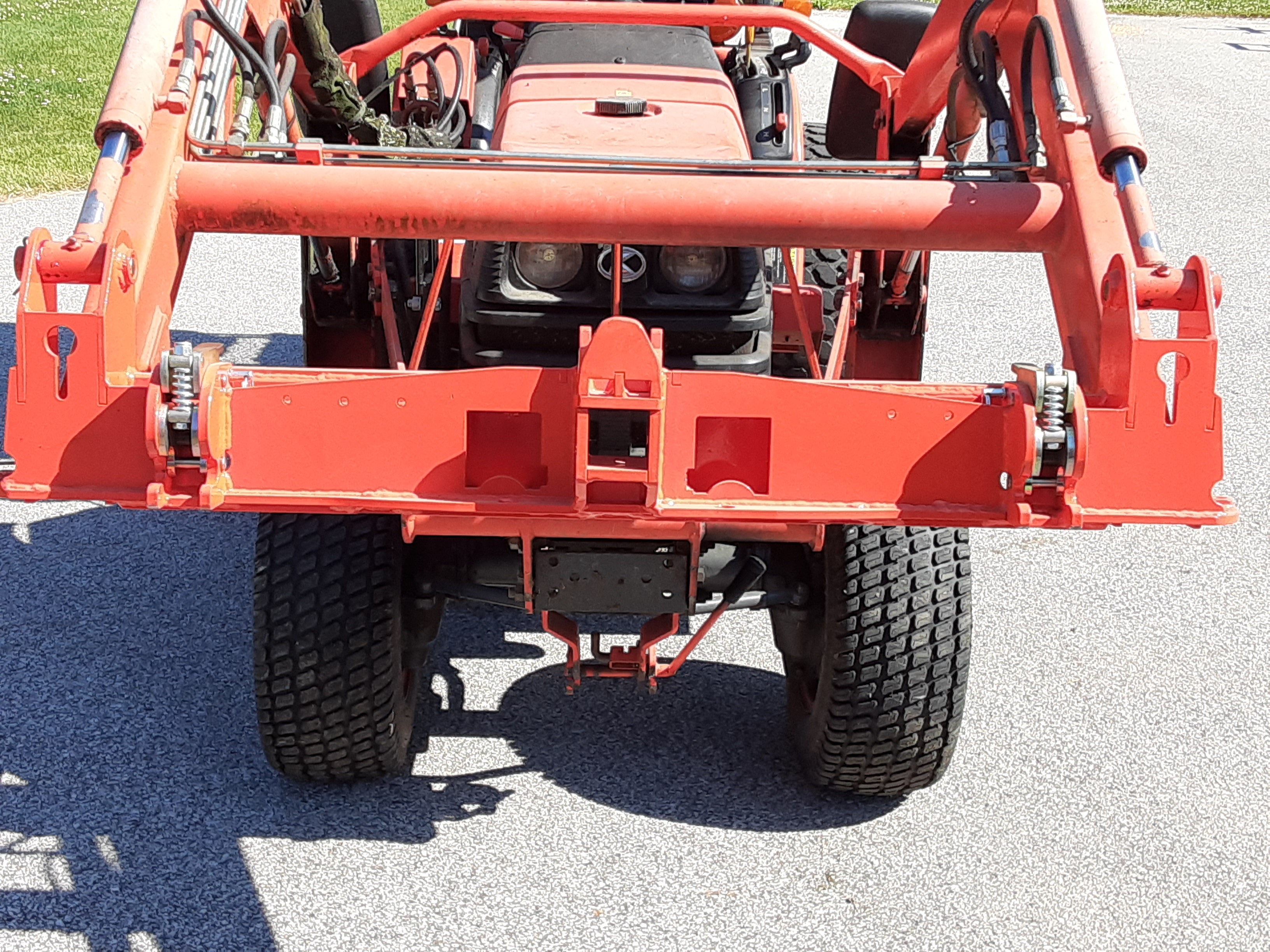

The Tach-N-Go Quick Attach from WWW.MYTRACTORTOOLS.COM is now available for the Kubota B7500 tractor with LA302 front end loader. I have the first production model installed on my B7500, along with a set of 42" quick attach pallet forks, also from MYTRACTORTOOLS.
My existing OEM "Square 48" bucket has been modified by addition of an adapter plate for use with the Tach-N-Go QA. I am now able to quickly change between the pallet forks and modified bucket, as well as use other quick attachments from Kubota and third party manufacturers for BX Series tractors. I am also now able to mow and perform other tasks, without having to remove the FEL (less attachment).
After 17 years of taking the loader off every time I want to mow and putting it back on to use the bucket, I may be down to once off for winter and the front snowblower and once back on for spring. :)
   / Tach-N-Go Quick Attach for Kubota B7500 w/LA302 #2
I'm a huge fan of the Tach n Go QA and also his adjustable forks. Been awesome on my BX25D. I never hesitate to swap the bucket for the forks and do it regularly in one minute I am guessing.
