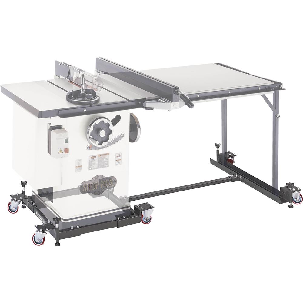

agree w/above, table saw much more versatile. for cutting ply, i went with a longer table set up to cut up to 48"+
mine is similar to this one. having a mobile base is handy as well, regards
10" 3 HP 220V Heavy Duty Cabinet Table Saw
