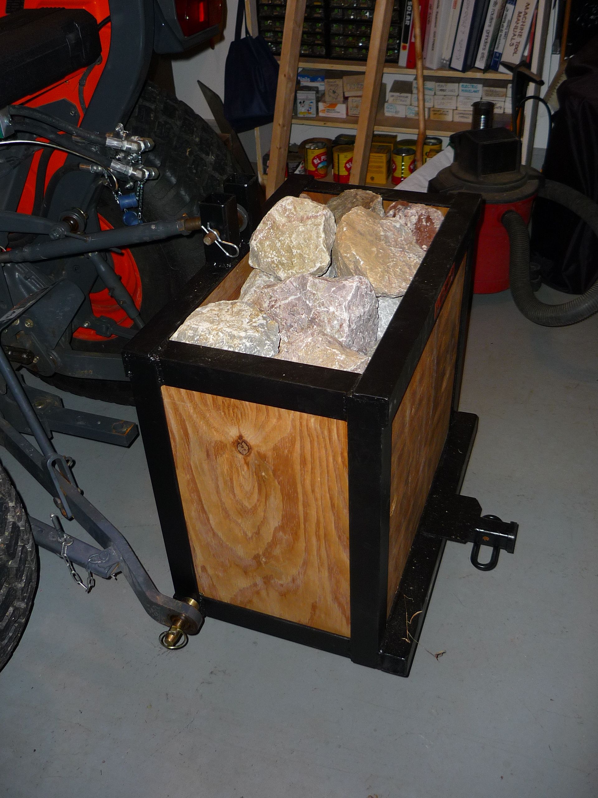

Hi everyone. I'm a new owner of a TYM T503 and would like to ask two questions about it. ( was a computer guy in my previous life ). Was hoping someone may be able to give me a bit of advice.
1. Ballast. The dealer has put some fluid in the rear wheels to help with stability but I feel that it is not enough. When using the loader to lift and move soil I get the feeling that it needs more ballast as I get an uncomfortable feeling that the tractor just is not stable enough. Am I being over critical or do other users feel the same way? solution is I guess to spend $500.00 and get a ballast box. Anyone bought one of these and feel that it made a big difference??

Yes seachange, any kind of weight you add behind the rear wheels will make your tractor more stable while using the front loader. It also has the added benefit of taking weight off of the front axle by having a weight behind the rear wheels and you always want to do that when using the front loader.
   / T503 ballast requirement. #3
Behind and low is what you want. I made this box for about $100 worth of materials, and I figure it's about 500 pounds with the dense rocks I have in it for now. As for your seat, does it have any spring tension adjustments? Most tractors do, although only a pricey air suspension seat will do for some guys.
   / T503 ballast requirement. #4
I also own the t503 and felt exactly like you about the back end being to light for the power of the hydraulics, used a ballast weight (about 2000lb) from a small old forklift, welded a 3pt setup on it using 3"x1/4" angle iron, cost 200 bucks from a junk yard, now it is rock solid and I can push dirt in 2wd.
Also the seat sucks, one of my biggest complaints, I ended up using a 10" lawnmower inner tube I had laying around, rolled it up loosely with the Schrader valve sticking out of one end, then wrapped a light cushion around it for protection, placed in under the seat and loosened the seat tensioner all the way, filled it with air to my liking.

I found that it takes a lot of weight to hold the backend firmly to the ground, there were several cases that the back end was still coming off the ground even with my Mott88 Flail mower attached (about 1100-1200lbs). Once I lifted a pallet of salt(63-40lbs sacks)just high enough to clear the trailer it was on and the back end came off the ground, that is when I decided it needed more and came up with the idea of the forklift ballast.
When I'm moving dirt I normally just hook the Flail mower up for ballast.

Seachange, all I use for ballast to move dirt is my flail mower 1100-1200lbs, the tractor is plenty stable even with a heaping full bucket of clay dirt. (on flat land for sure, lol)
