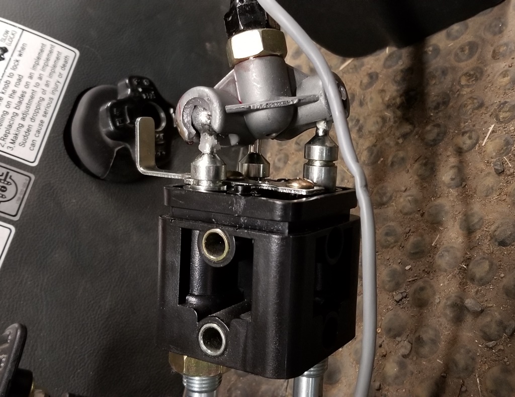

I have a T454 and I'm a little new to tractors. Using the FEL today I felt a "pop" or "snap" in the joystick. No hydraulic leaks. No other issues.
Now the joystick won't raise the loader. All other functions work fine. The joystick control will lower, dump and curl the bucket...just won't lift it. The joystick is complete limp...no resistance at all, when moving it to the rear (lift position).
I've removed the cover and boot around the joystick but don't see any obvious problems.
Any ideas? Of course the manual is of no use. I can't find an online diagram or parts catalog and can't call the dealer until Monday. Hoping someone might have some insight into what might be the issue.

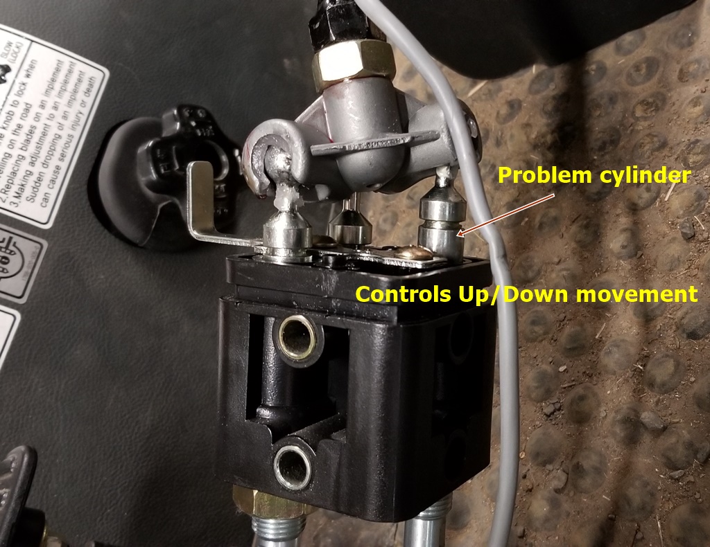

Here's a few pics of the joystick control box (not sure what it's actually called. It appears to be a sealed unit. The cable that controls the inoperative cylinder appears to be attached at the hydraulic control manifold. I tried to loosen/remove the cable from the cylinder but it's still attached somewhere in the box. So I'm at a loss as to what to do next. Any advice or suggestions?

My guess is your cable to the "bad" Cylinder snapped it happened to me a couple of winters ago. Jordan in Post Falls should have replacements in stock. I don't know if you could get a generic cable from a closer dealer. Connecting to the valve is easy but the upper end connects to the joystick and that took me much longer to figure out. You can switch your hydraulic lines if you need to raise your loader.
Below are pics of the joystick, I had to loosen all three of the "ball" ends to get the new cable into the slot.

It was the connector at the other end of the cable where it connects to the hydraulic valve. There's a pin that goes thru the valve and a sleeve that attaches the cable to the valve. That sleeve (looks like it's made out of some cheap pot metal) broke so the cable was loose on that end. Dealer is sending me a new one and a spare.
But, since you mentioned it, how do you get those balls out of that mount? I looked at it and fiddled around with it but couldn't figure it out.
I also couldn't get the joystick removed. It's got a welded on nut at the bottom and is secured by a second lock nut. I can loosen the lock nut but can't get the joystick to move. I didn't want to force anything and screw it up even worse than it already is.
   / T454 Loader Joystick Issue #5
If I remember correctly you remove the brass colored slide piece that is held on by the two screws and loosen the nut on the cable and push the cable/ball ends up to give you enough slack above the plastic to manipulate all of the balls at the same time. I had to walk away from it a couple of times and think about what was going on to get it out and reinstalled.
