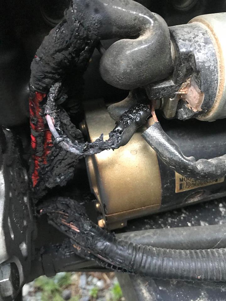

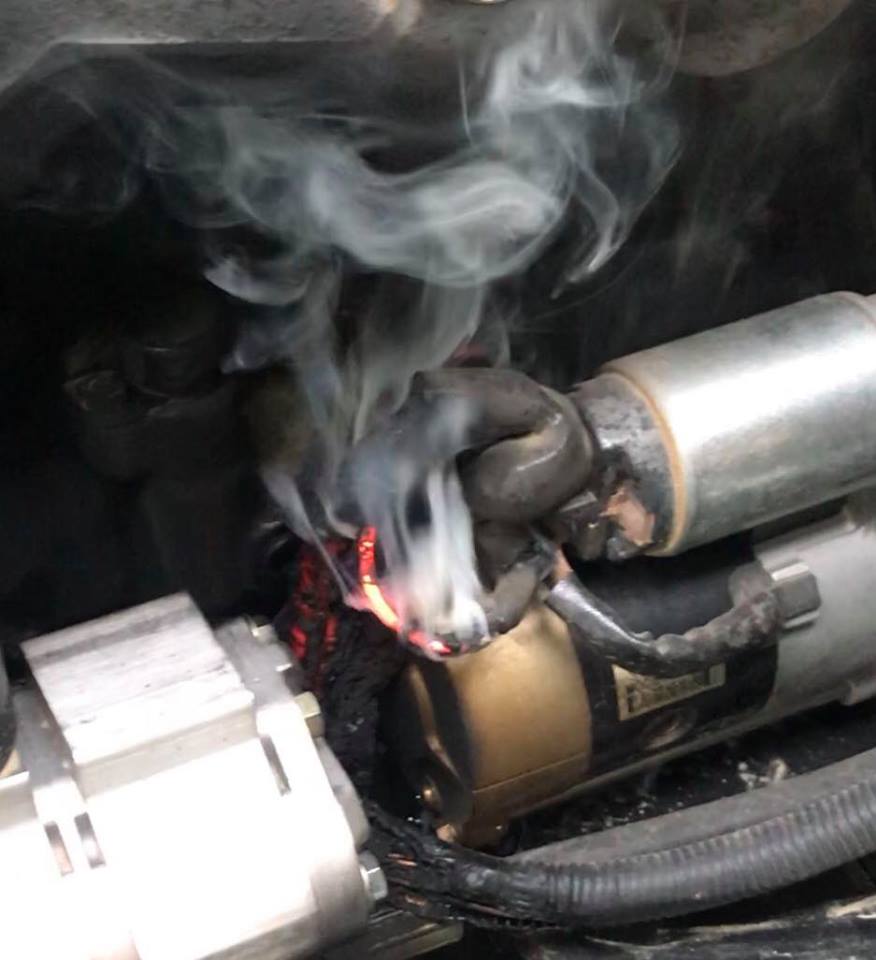

Hello, my Cabelas branded TYM T353 tractor had an electrical short and burnt through the wiring harnesses in both the engine compartment and dash.
I've purchased new wiring harnesses but need help with the wiring going to the starter.
Can someone please post a pic or diagram of "what right looks like" please?
The pics I have of when it was damaged are not as helpful as I would like.
Thank you!

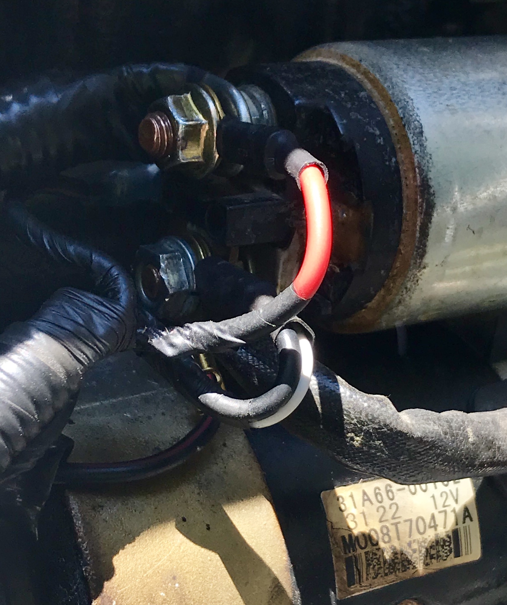

Here is a hat I am thinking:
Single Male Pin: Single wire with factory female connector
Top Post: Battery Cable and Red Wire from Harness
Bottom Post: White & Black wires (single post connector) and Black wire with Red Stripe (all from harness).
   / T353 Starter - Need Help with Wires
Does this look right?
