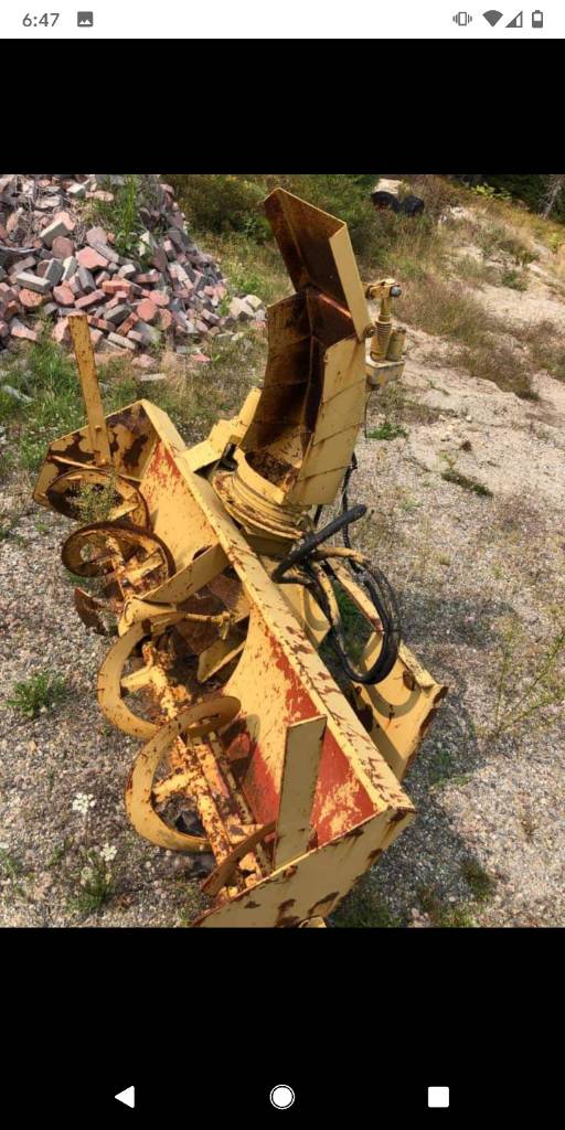

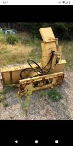

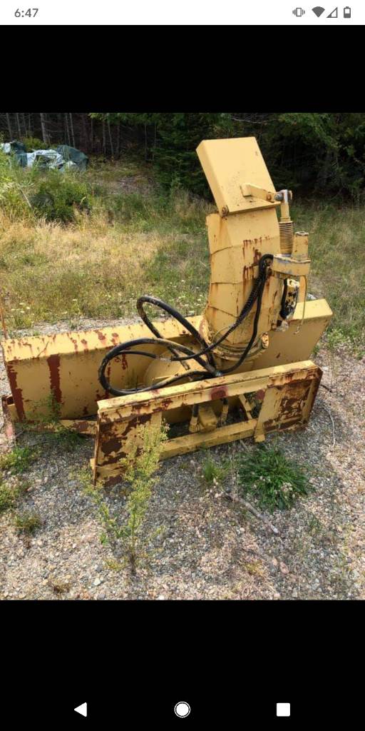

Hi All,
I am contemplating purchasing a front mounted hydraulic snowblower for my TYM T330.
Price is $500. 6ft blower. Seems very reasonable for a hydraulic snowblower.
Question is, do I need a separate resevoir tank for this. Guy selling it says I should be able to just hook it up to my quick connect lines on the front.
I am also concerned about the GPM needed to run it. Seller does not have that info. I am thinking I might be a bit low on that end.
For $500 I am willing to give it a shot, if it doesnt work out I am sure I could clean it up and sell it for more than I paid.
Any thoughts? Thanks!
-Tyler

Yea I don't think 10gpm is going to run a 6ft snowblower very well. I think I will pass on it.
