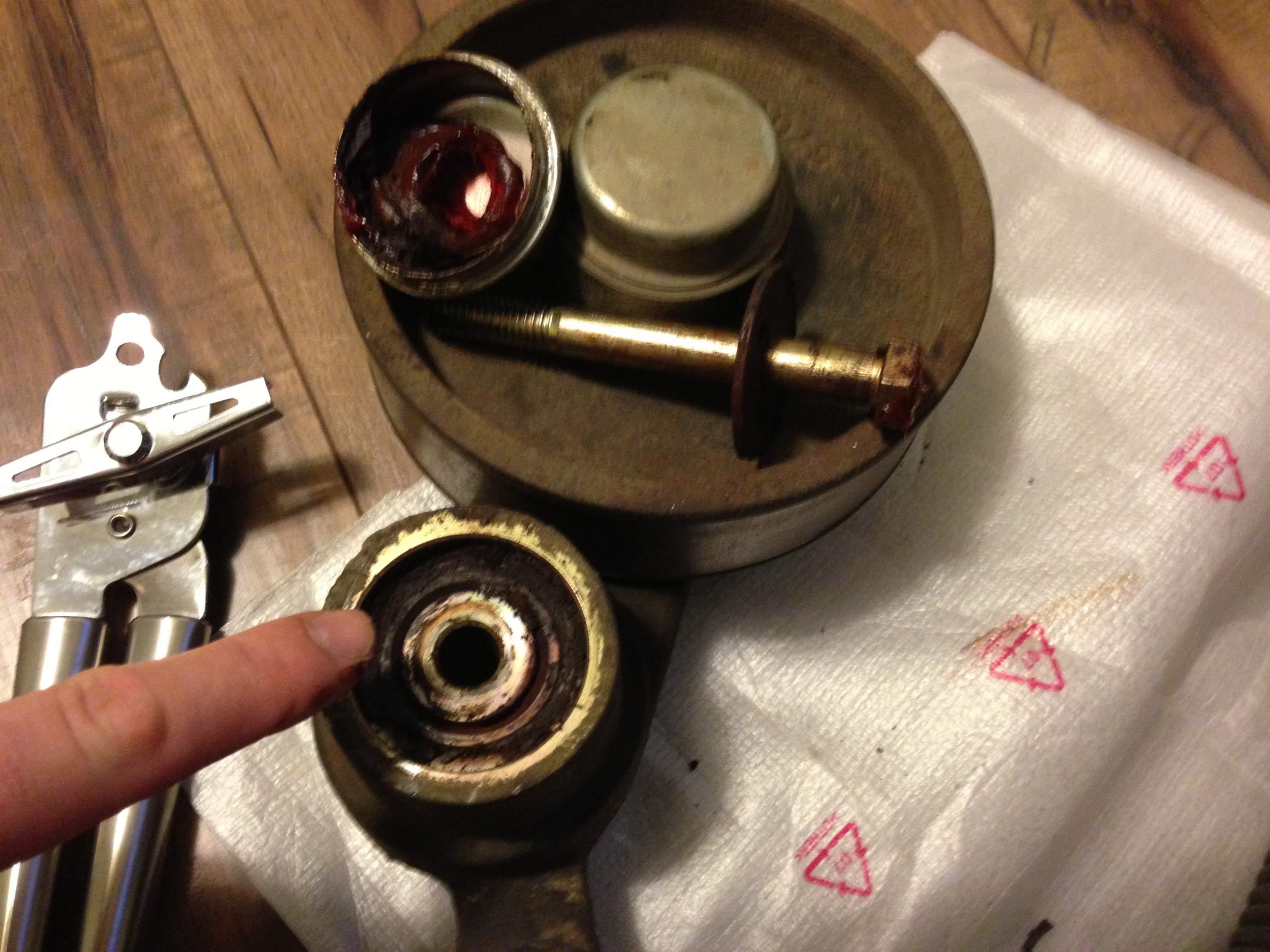

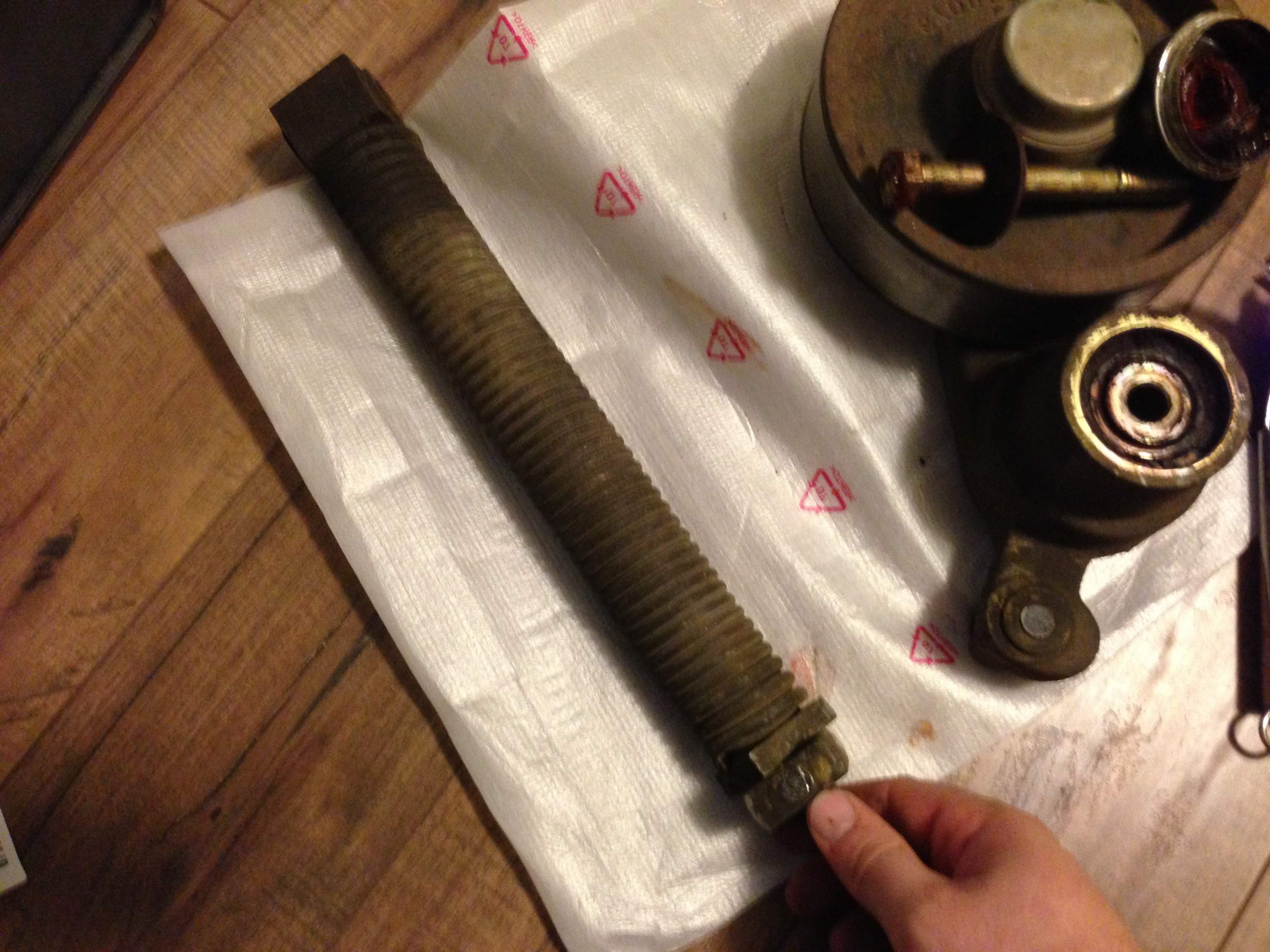

Hey guys, thanks for all the tips. Today I removed the old drive belt and slipped the new one on. To be honest the old one didn't look bad - the teeth seemed to be in good shape and the belt overall didn't look too worn.
However, when I attempted to loosen the tension spring to relieve pressure on the old belt for removal, I ended up shearing the bolt that attaches the tension spring end block to the tensioner pulley. :duh: Here's a shot of that -
Once that happened I had to remove the whole tensioner pulley/ tension spring apparatus to get that repaired. In doing so I noticed that the internal bearing of the tensioner pulley looks like it had blown out its grease. Pic of that -
You can see the cover piece in the upper left is filled with grease. The bearing near my finger isn't budging. So I think this could be my entire problem. I'm going to see if I can take that bearing apart to repair it or if I'll just have to buy another one from Bobcat. I'm going to have to buy a new end block for the tension spring anyway so I'll probably just get both.
It's always something!!! But hopefully I'm on to the source of the "extremely low hydraulic pressure" problem... I'll update as I go for anyone interested.
   / T300 - Low Hydraulic Charge Pressure
By the way, I've got to find a way to remove the sheared stump that was left in the tensioner pulley - you can see it in the middle-right of the first picture I posted above. Any suggestions? I was thinking of drilling it, heating it up, and then using a screw extractor. Not even sure that it's threaded though.
