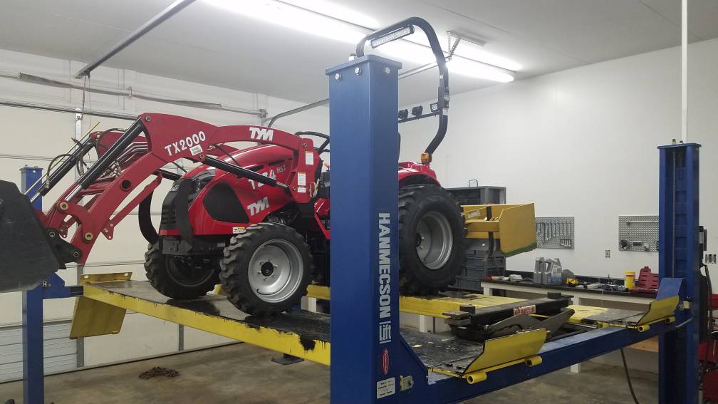

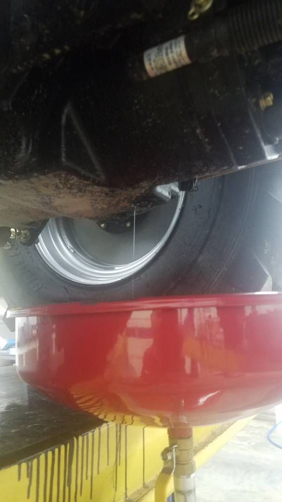

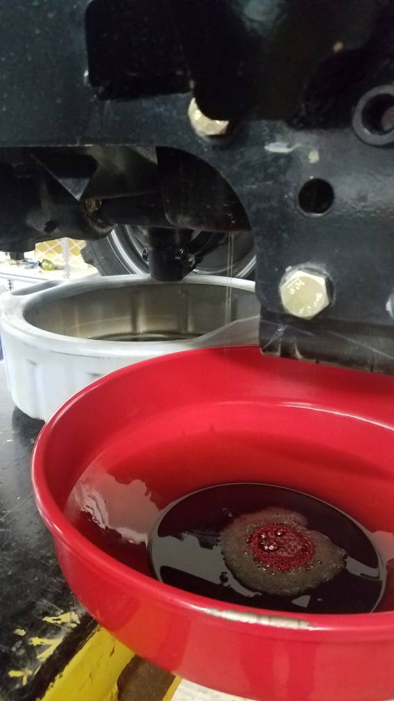

Draining the front axle and engine oil was easy peasy.
The front axle oil was very clean. I drained from all 3 ports, lower right, middle, and lower left. Replaced with MasterPro 80w-90.
The engine oil was darker than I expected for only 50 hrs. 2 drains on the bottom of oil pan. Replaced with Shell Rotella T5 10w-30.

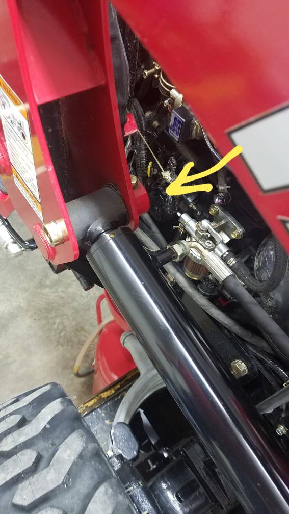

The oil filter was in a horrible location. Probably easily accessed if the tractor did not have a loader. Had to run out and buy oil filter pliers as none of my wrenches would work. Even my strap wrench couldn't get it off as I had no leverage in the tight spot.20180710_215056.jpeg

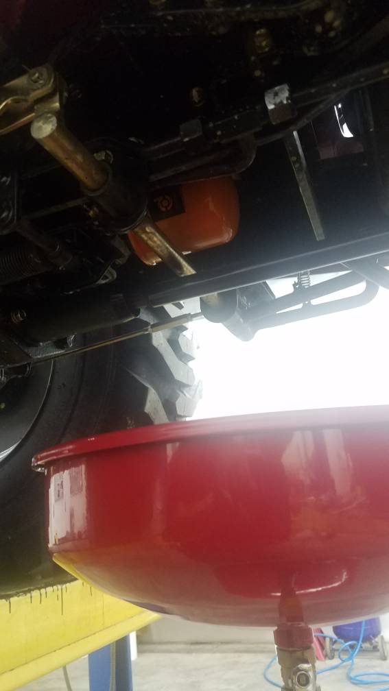

One rear hydro drain. The filter for this was also difficult. The pliers came in handy. The manual I have is for the T293. I could not find the hydro strainer. I removed pieces of metal off the drain plug magnet and from around the filter inlet. I have a hose ordered that has a slight cut on it. When I recieve it. I will drain and definitely find and clean strainer.20180710_194855.jpeg20180710_204048.jpeg
   / T234 50 hr service....good and bad.
Rear was replaced with Hyperion UTF and a Donaldson filter.
It will definitely go better the next time. The engine had never ran smoother!!
