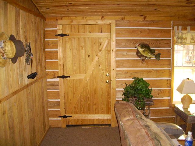

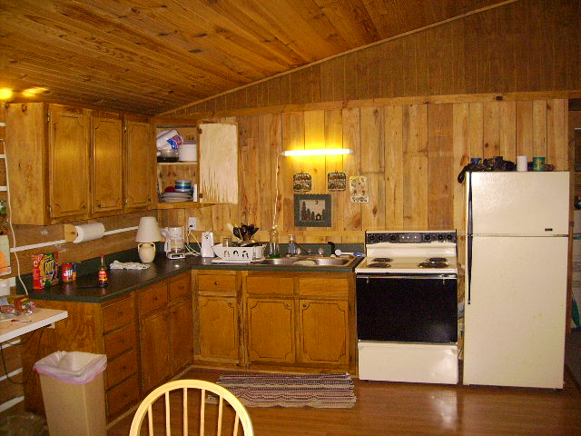

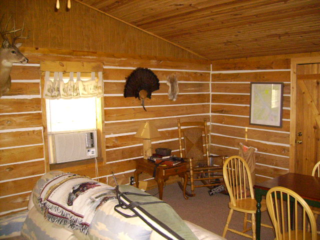

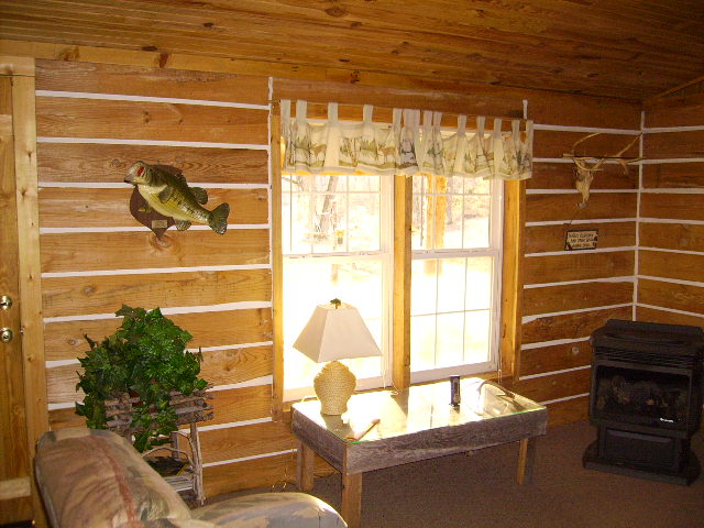

I put up T&G pine ceiling in the getaway log cabin I built. I didn't finish either side. That's probably been 8-10 years ago. The exposed side still look like the day I put it up and there is no cupping or warping that I can see. I have a metal roof so I don't think there has been any leaking. In my opinion, finishing is strictly an option, not necessary.
The pictures were not taken to show the ceiling, but it does give you some view of the ceiling.
