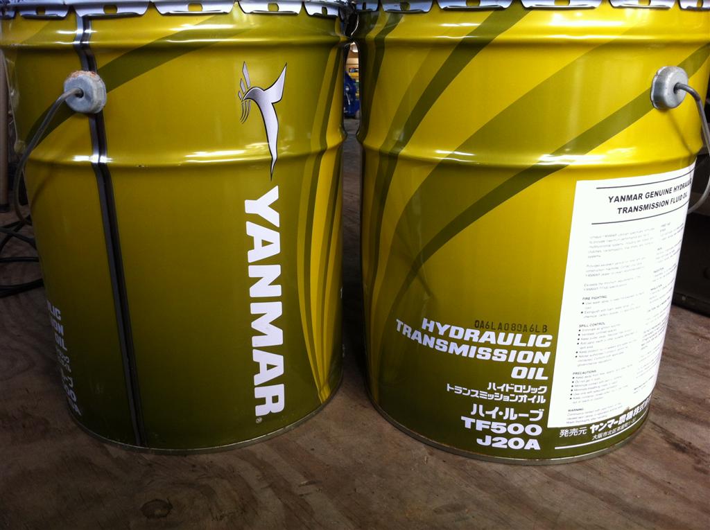

Yes, I've attached a pic of the Yanmar TF500 fluid, as you can see its interchangeable with John Deere J20A, so theoretically anything J20A and above should work.
My dealer was frustrated with the steel Yanmar buckets getting dented during shipping and stopped ordering it, so for my second fluid change they sold me AGCO Permatran 821XL fluid, they had that on hand since they are also a Massey dealer.
I have no complaints with the Yanmar fluid tho, it seems to work fine in low temperatures, and I like the red color for reading the level on the dipstick.
