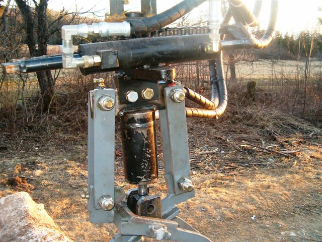

Thinking about constructing a pulp trailer with a loading boom. Anyone know where a hydraulic swival could be purchased to operate a clam ? I have seen a unit made in Canada that is pretty compact. A new one may be quite costly depending on size and capacity.

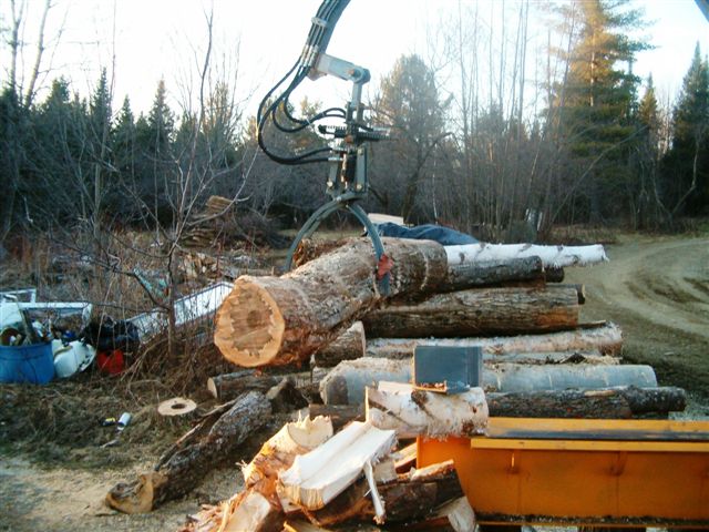

I built a loader for my splitter using a steering cylinder and # 40 chain for the head swivel, mount the cylinder horizontal wrap chain around bushing and hook to ends of the ram twists 180+ degrees allowing you to grab wood at any orientation I could take pic if you want

Please do ! It may give me some ideas as well.:)

heres my loader

That looks simple yet effective. Sizzami; did you build this?
