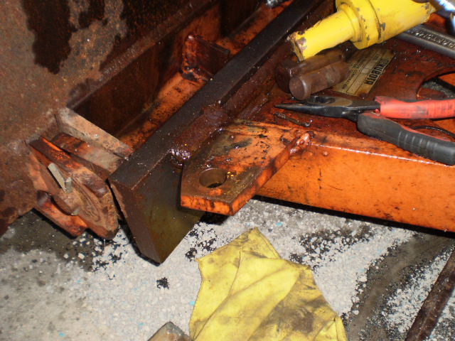

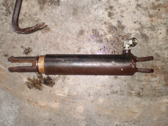

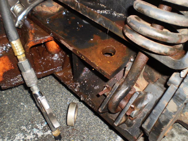

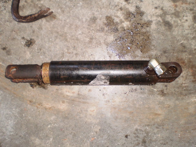

/ Switching to one plow cylinder? #11
Here are some pictures of the cylinder and the mounting setup.
Thanks...Those sure are oddballs! Can you weld/fabricate? If it was mine, I would adapt standard Meyers/Western style plow cylinders.
#15
Thanks Kenny.... That shouldn't take to much to fabricate.
