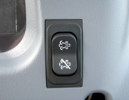

There is a switch on the dash on the right side above the throttle. What is this for? Momentary rocker with same symbol top and bottom. Bottom has a slash line through it.
Forgot to mention the dealer forgot to give me the operators manual before I left the dealership so he is going to send it to me. No big deal. Thanks in advance.

Its for the tier 4 exhaust system. Holding the switch down for a bit gives you the ability to force the system into regen mode which it will do on its own every 4 hours or so. I don't have my manual with me for the exact terminology but thats the rough of it.

I think the real use for the switch would be to stop the regen. cycle of you were operating in tall dry grass or the like. The exhaust temp, during regen. cycle is very high.

That makes sense with the line through the symbol.

This one?
Looks like a 2 position momentary switch. Up looks like to force a regen and down to stop one. I don't have a manual but that's what it looks like from the picture from the LS website. They have it labeled as the DPF switch.

Yep, that's it. Is there a dash light indicator that tells you when it's in regen?
Yes there are two yellow light in the dash that light up when active. An explanation is in your owners manual what each dash light means.
