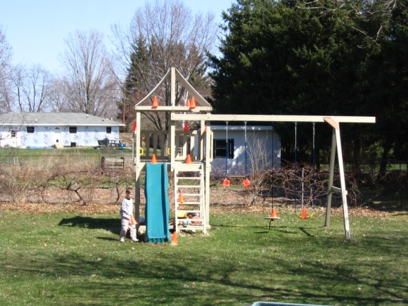

Here is a photo of the one I built my son a couple years ago. I used 4x4 pressure treated posts, 2x6 or 2x8 (can't remember) doubled for header.
Bolted together with countersunk nuts so they don't catch him.
Also used normal pine for everything besides the ground contact portions and the header beam.
It is holding up well and heck he even uses it once in a while /forums/images/graemlins/grin.gif
