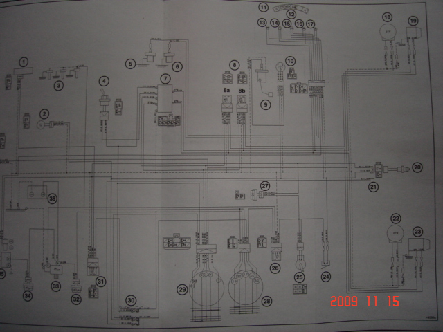

Folks need some help with locating some sway chains for the little beast ,:dance1: the sway chains stabilize the brush hog and any other attachments ran on the PTO. Every time I loan It out it comes back missing something :confused: I am also in need of a fuel diagram and electrical wiring diagram.

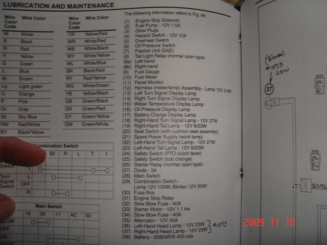

Ditto on the suggestion to purchase the service manual(s). They ain't cheap, but are a great investment. I'll look tomorrow to see if I can locate the diagrams you're looking for in my books, but they'll be on a photo and pretty small as a result-- though they may help.
After looking, I see I have some electrical already in my pic library; here they are.
