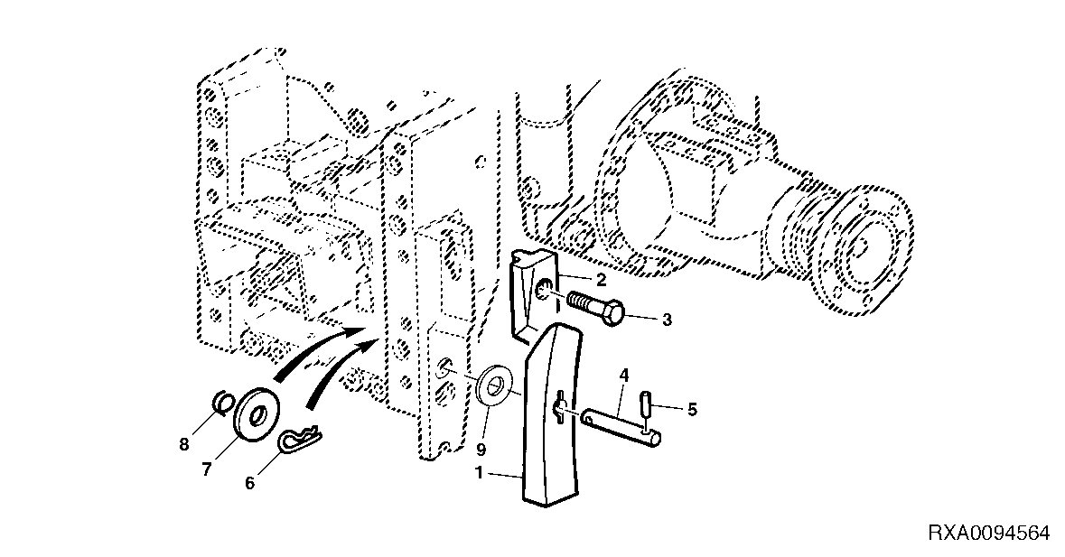

Does anyone know what the sway block spacers are to take up excessive sideways motion on the 3 point hitch
Thanks

Here is the breakdown. there are upper and lower blocks on each side.
Page Name: SWAY BLOCKS AND SUPPORTS
key PART NO. PART NAME QTY SERIAL NO. 7220 7320 REMARKS
1 L100866 Sway Block 1 X X RH
L100865 Sway Block 1 X X LH
2 L100868 Sway Block 1 X X RH
L100867 Sway Block 1 X X LH
3 19M7396 Cap Screw 2 X X M16 X 45
4 L77502 Pin Fastener 2 X X
5 34M7042 Spring Pin 2 X X 6 X 40 mm
6 A3581R Spring Locking Pin AR X X
7 L115365 Washer AR X X
8 L55222 Lock Washer AR X X

Thanks for the reply. So would the spacers be num 9. I am hooking up to a 3 pt drill and have a lot of sway. The manual says to contact the dealer for the spacers and they have no idea what I am saying and I can't find anything on jdparts

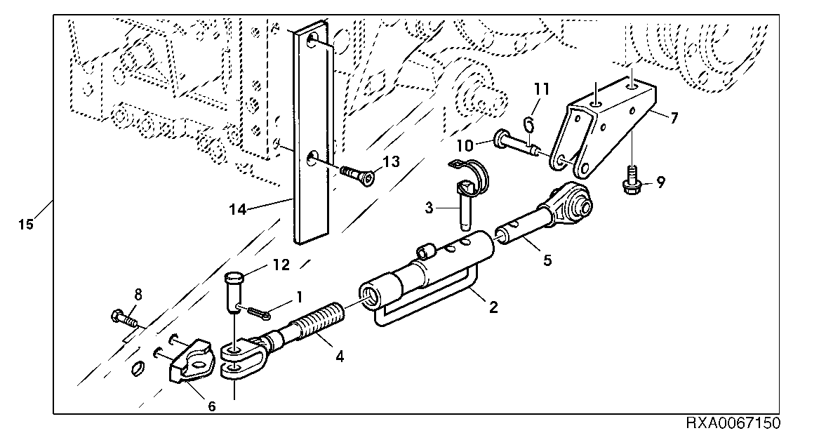

Maybe the adjustable stabilizer bars are what you need?
