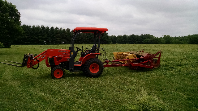

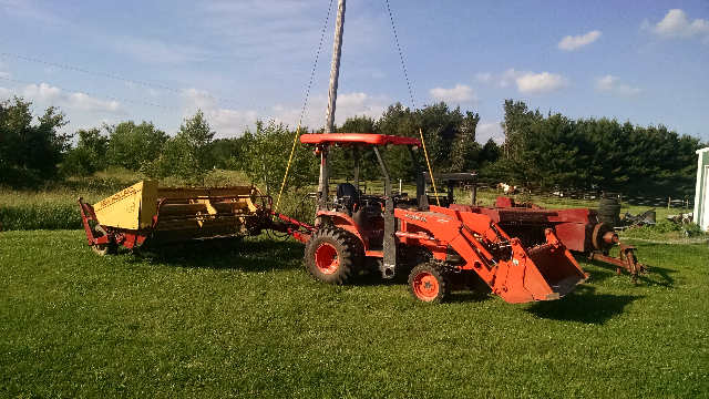

I picked up a 472 NH this spring at an auction and my B26 Kubota pulls it fine in medium range as fast as it will go. My land is fairly flat and this little tractor is very handy on small fields. Even as wet as it was this year it didn't plug. 100% better than an old sicklebar mower.
