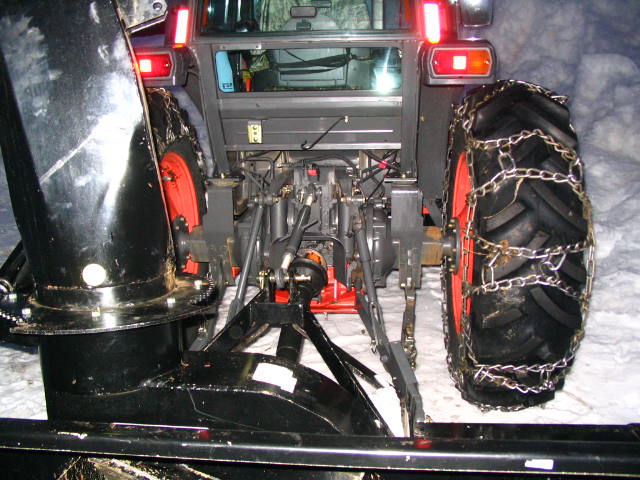

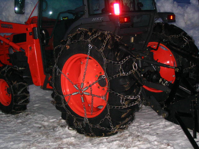

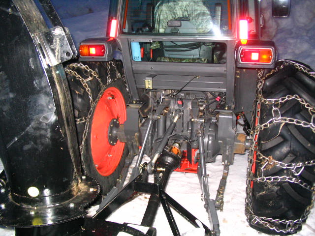

I used sections of 6x6 lumber, raised the rear (both sides at once) with the BH outriggers, slide the stacks of 6X6 under on pre-positioned 2x6's (so I would not be under the tractor at any location) and then lowered the tractor onto the 6x6's. I kept the outrigggers down by just enough to add stabilization, not support.

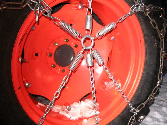

Remove the wheels from the discs (the large steel centers), (the disc portion should be "cupped" to the outside) and then roll the tire/wheel backwards toward the rear of the tractor, (without turning the tire/wheel around in a different orientation) and then forward to the opposite side and remount. Simply reverse, and then forward, do not spin the tire.
When you are finished, it should buy you quite a difference. Some pics below of the end-result:

The key to rolling the wheels is to keep them upright. Go very slowly, do not allow tipping from vertical, and then you are not supporting any weight, just rolling the circumference. There is little to any effort in the rolling.
The hardest part is the re-mounting process, aligning the bolt holes and slipping the bolts in while maintaining that alignment.
