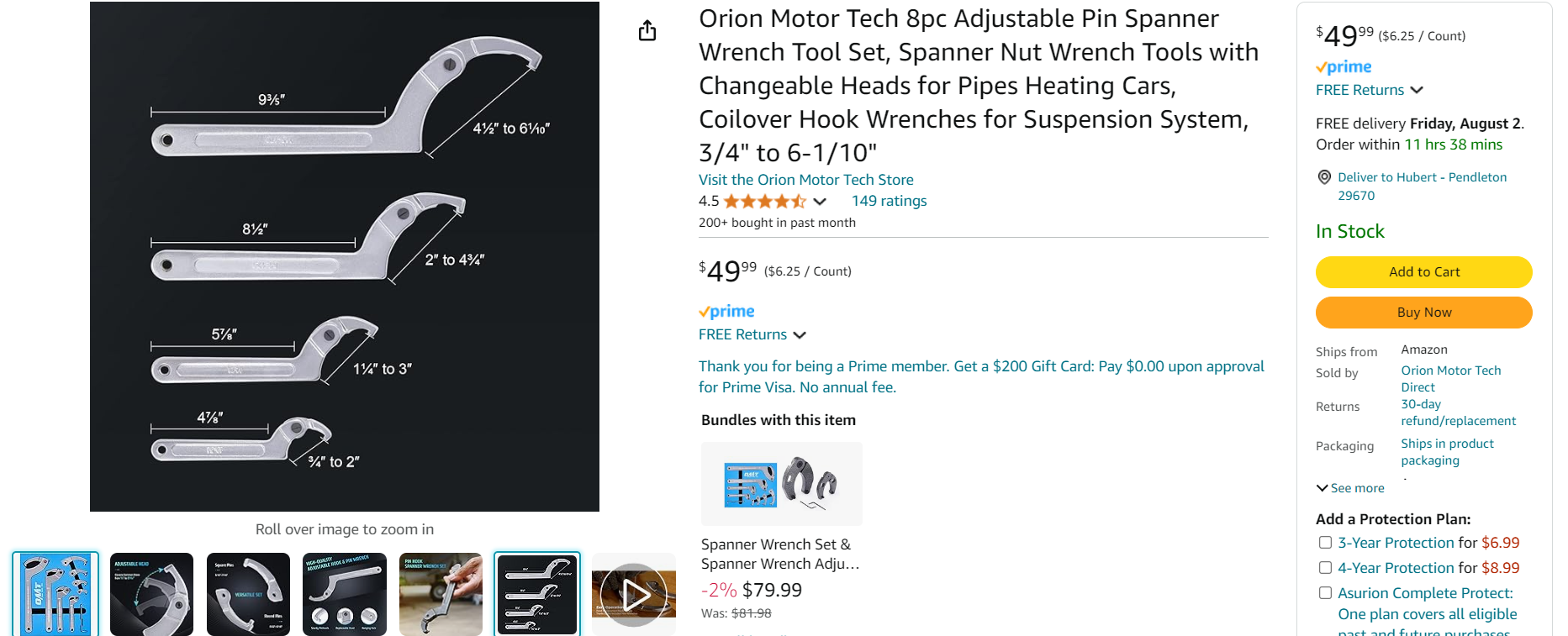

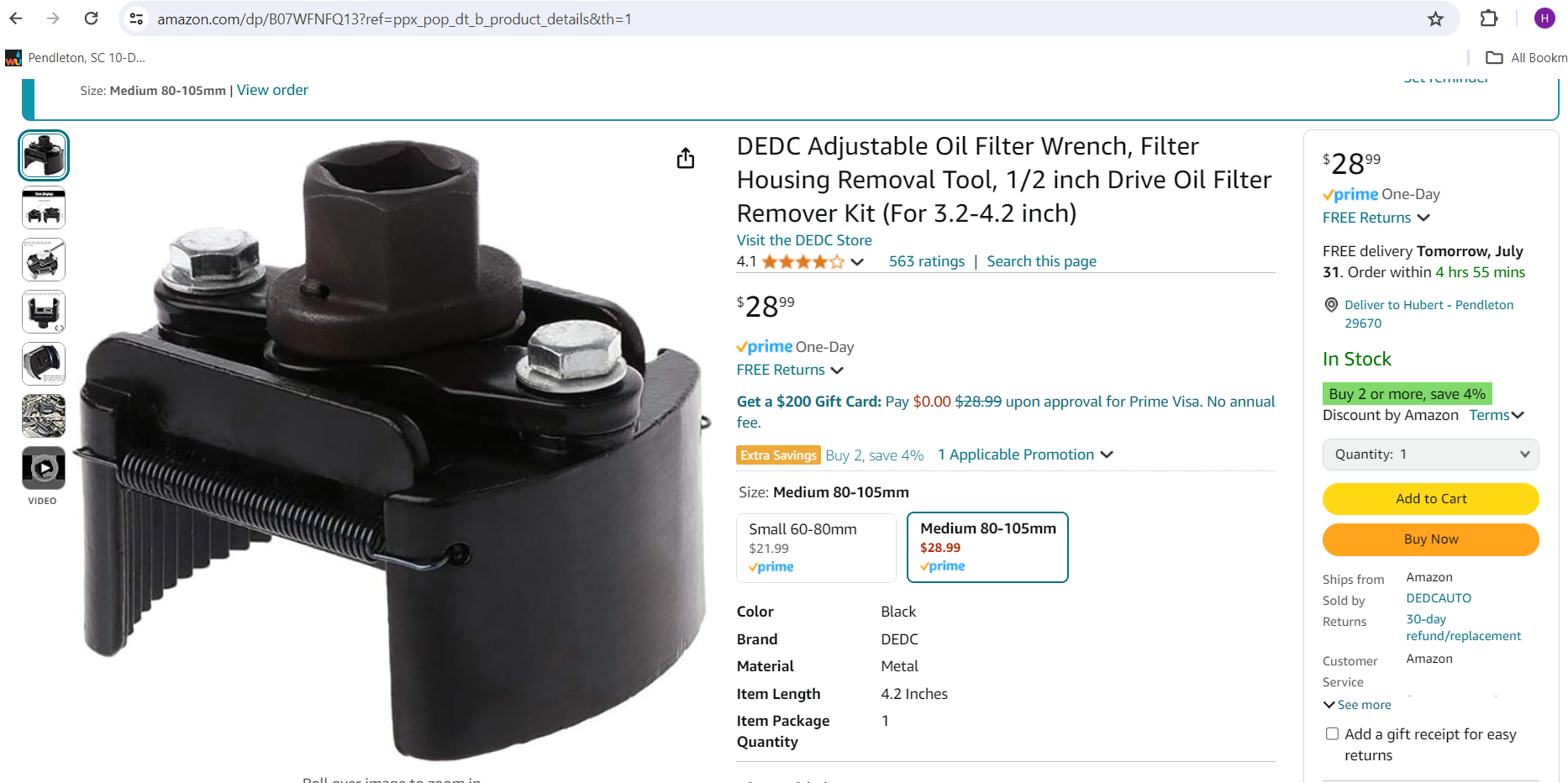

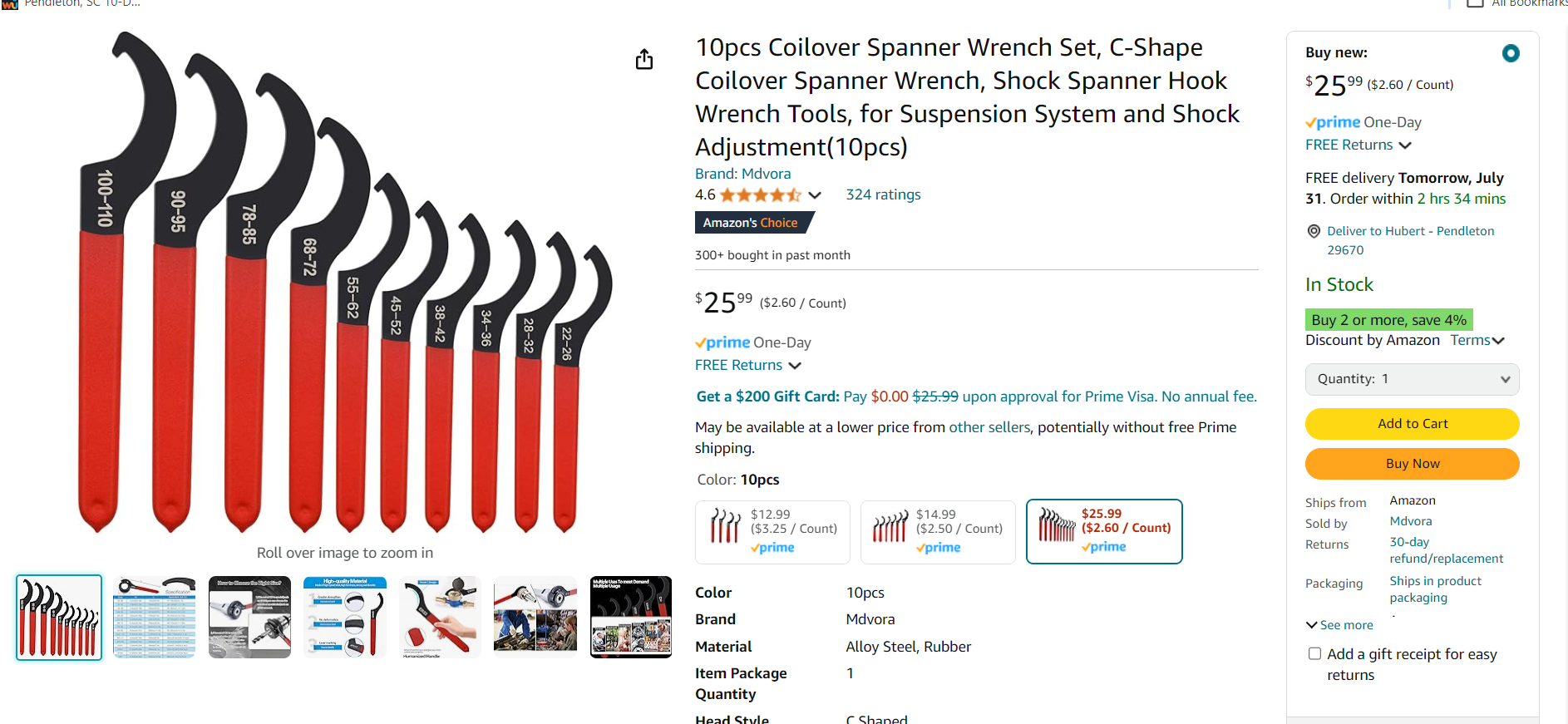

It was just super tight. Not likely going to get this off with an avg or even good oil filter style wrench. We eneded up using an OMT hook spanner with 3ft cheater plus an end cap style filter wrench with a long 1/2 drive ratchet. Had 2 people torque it off.
I had tried this red handle hook spanner and it was ok fit but the OMT adjustable spanner seemed to get a better torque on the filter. The way the red handle hook spanner was it did not seem to wrap around the filter as much.
I would recommend the OMT spanners and not the red handle ones. The end cap filter wrench was OK. I would probably buy a different brand next time. One with a little deeper grippers
