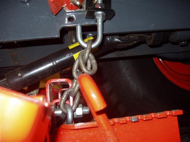

I modified the 60" MMM on my B3030 so that the center wheels in the back of the deck would not leave tracks. (see attachment) I still use the front wheels to keep the front of the cut consistent. I have the chain hooks adjusted so that the weight is just off of the rear wheels. I then raise the rear wheels all the way up so they don't touch the grass. This has worked out so well that my next step is to remove the rear wheels altogether so mounting and removing the mower will be easier. I, too, was concerned that the wheels would leave tracks in the ground when it is wet in the spring. I have mowed the entire lawn three times now since using this system. It has worked perfectly and the lawn looks great when done.

This picture shows more detail of the hook. The holes that the angle iron is bolted to were already in the frame.
