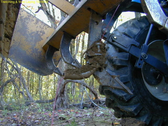

For most of you, there isn't much "building" to my recent project, but for me, it was an accomplishment... /w3tcompact/icons/laugh.gif
With my box blade, I made a "trenching-wire laying" contraption for installing our pet radio fence that actually worked pretty well. The nice thing was that it was made from stuff lying around collecting dust > thrifty or cheap as my wife would say. /w3tcompact/icons/smile.gif /w3tcompact/icons/eyes.gif
I used exhaust pipe clamps to attach a 90 degree angle sweep piece of 3/4" schedule40 pipe to the middle digging tine of the box blade - turned away from the digging point.
Here's a picture of that (with dirt attached /w3tcompact/icons/smile.gif).

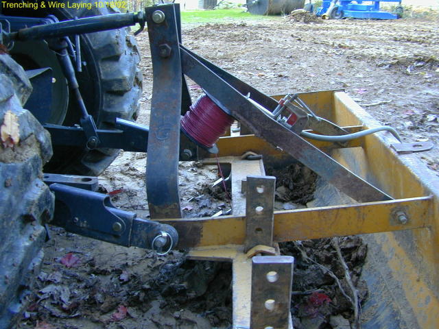

I used 2 C-clamps to attach an old garden hose roller the 3 pt support bracket of the box blade. The spool of wire slipped right on the roller axle allowing it to hang just over the middle tine. /w3tcompact/icons/smile.gif
Here’s a picture of it…

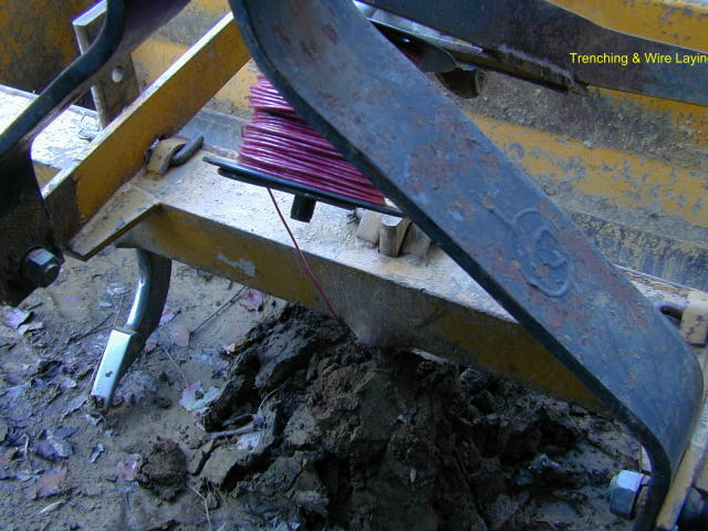

It took me about 15 minutes to make it & 2 hours later, almost 2000’ of wire was buried /w3tcompact/icons/smile.gif
The digging tine would tear through the roots that I had to get by in the wooded area & lay the wire down under them. I tried to adjust the height of the boxblade as I went so that the back edge just slid over the ground so that it would actually cover the trench back over and not dig up much ground. I only had to go down 3-6 inches with the wire. I ran the wire through some old garden under the driveway.
Here’s another pic of the setup…

Ah, yet another variation on the subsoiler line/pipe layer routine. If you mount a post with a right angle extension on your box blade, you can just place a large spool of wire on it, and have an "automatic wire laying device", as the wire runs off the spool, down the tube (preferably mounted on the back end of the blade) into your trench.
