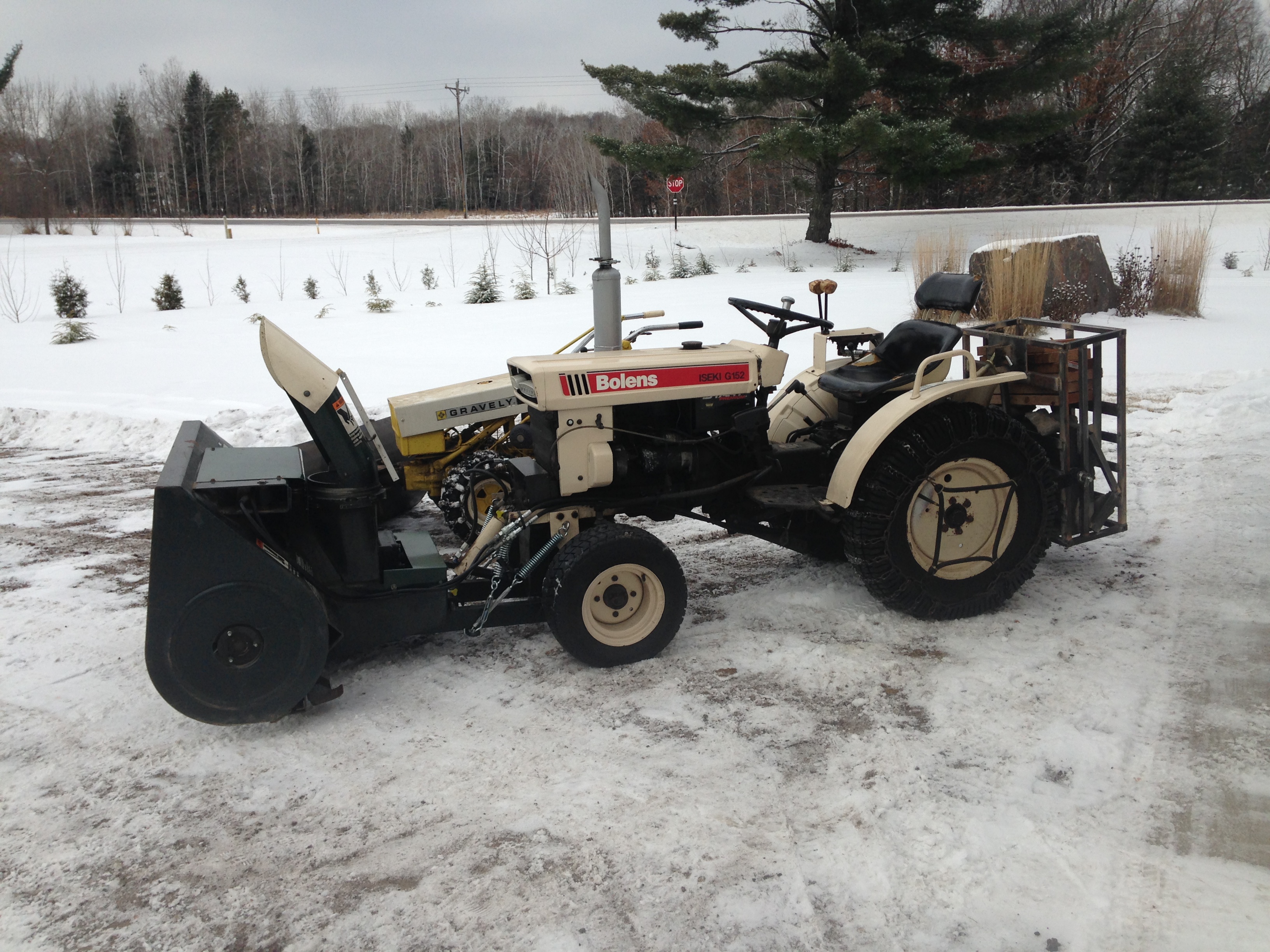

I知 looking forward to a diesel that will actually start without being in a heated space, having the block heater plugged for at least a few hours, and cycling the glow plugs at least four times. Did I mention cranking it over so much I have to put the charger on it also?
My old tractor is a Bolens G152 (Iseki TX1300F) with a Mitsubishi KE70 2 cylinder diesel. Cold blooded doesn稚 quite cover it.
