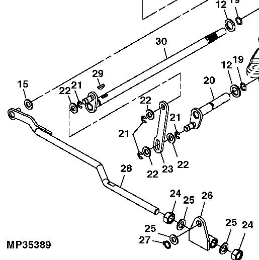

I have a 3720 and I had replaced the big plastic pan underneath the seat and where all the controls go through such as the 3PT control and the FEL control and parking brake and all of those things to operate the tractor.
Since I did that I noticed after I got home with the tractor, wouldn't you know, that when the 3PT control lever is all the way in the up position, I noticed a surging sound or a deadheaded pump sound coming from a pump of some sort. If I lower it about 1/2" the noise goes away. When it is all the way up, the performance of the tractor decreases somewhat. Maybe 10-20%.

It sounds like the feedback linkage is out of adjustment. If it is too tight (at least on my tractor) it will still be trying to lift even though it is physically out of travel.
If the "shop" had your tractor, and repaired something in that "area" and now all of the sudden this happens....I'd take it back and make them make it right.

LD1 is onto the problem.
Here is a pic of the feedback linkage on the 3720. It is on the left side between the fender and seat. Just a short rod that is adjustable and likely needs just a small tweek.
There is a procedure, but likely a small adjustment will let you know real quick if that is the fix to the problem. I am thinking lengthening that rod will tell the internal valve that the rockshaft is at its highest position and not try to raise it higher.

Thanks folks. That's what it was. It was easy to fix when I knew what to look for. Just that info paid for my subscription on TBN. :thumbsup:
