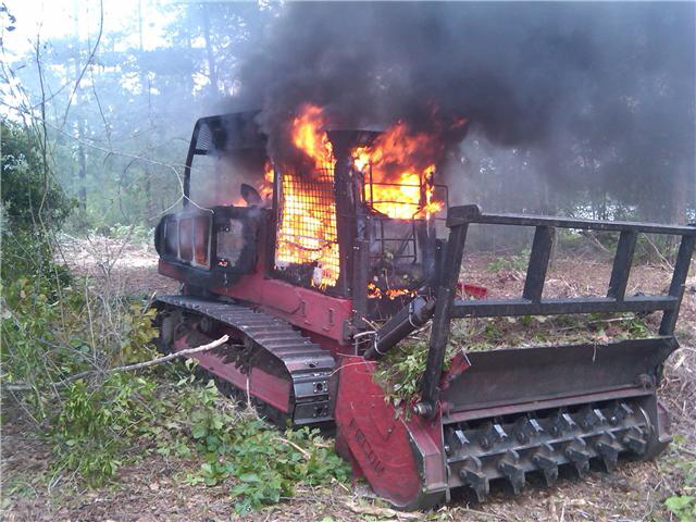

Here is a pic of one of our ftx 140 s that brunt last monday

i'm sorry im new to this look on my profile
   / Supertak SK140 vs Fecon FTX 148 ?? #10
10-4
is the picture in my profile
