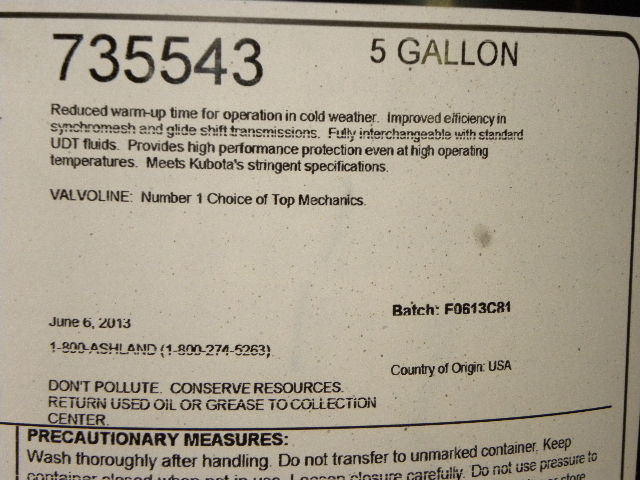

Just picked up a 5 gallon bucket from local dealer and was reading label, label states that SUDT2 is made by Valvoline for Kubota.
There maybe a Valvoline branded UDT that is the same at cheaper price, haven't investigated it yet. DSCN0536.JPG

I haven't heard of or found a replacement and I've looked.
I'll stick with the SUTD2.

Some manufacturers include special additives to the specs of the merchant. Kubota SUDT2 may not have an equivalent in a Valvoline product.
^^^ What he said.
It's been long suspected that Valvoline made SUDT. But it's probably not just a brand name change from a standard product.
