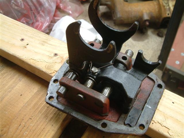

Right now I'm focused on getting my 1951 Minneapolis Moline BF restoration finished. I pulled the cover off the transmission a few weeks ago. It's a simple gear tranny 4F/1R, no synchronizers. Here's what the inside looks like.
These are the 3 forks and the rails. The two large forks handle the 1st/3rd and 2nd/4th gears. The small fork handles reverse.

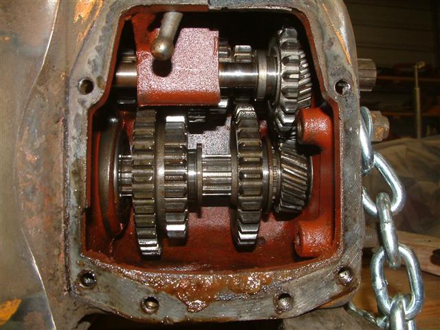

The gears are simple straight cut spur gears except for the reverse gears which are helical.
The short shaft with the ball at the end is the shifter rod that moves the gears on the rails.
My guess is that your tranny is not much more complex. Hope this helps. Good luck.
