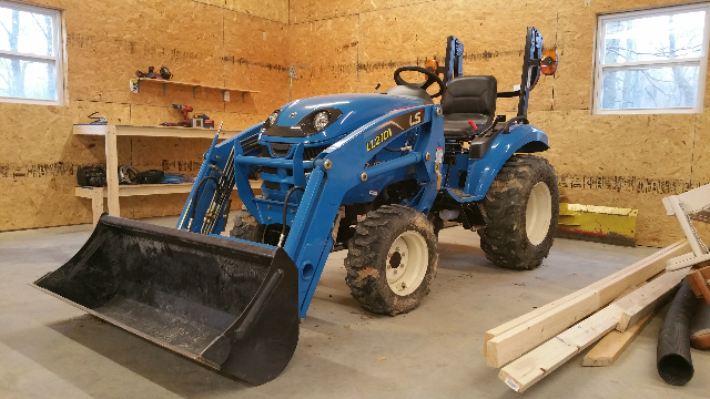

You're doing yourself a disservice my not considering LS in your search. J2023 or XJ2025 would meet your criteria. I bought a new 2023 at the beginning of last year and paid $12,200. Comes with the best warranty in the business, 3 year bumper to bumper, 5 year powertrain. I live on 6 acres and it's plenty of tractor for my needs. Has more loader lift capacity than direct competitors and larger gpm hydro pumps. Easily the best bang for your buck in the CUT market.
I was in your same boat and what I learned was that Mahindra looked and felt cheap and did not have near the fit and finish of other brands and they were expensive, more $15-$16k for a 25hp model. Kioti was very close in quality to the LS I bought, made in South Korea just like LS, but didn't have the same warranty and was about $1500 higher. Kioti would have been my second choice. Kubota was way outside my budget for CUT, their SCUT was even outside my budget. Same with JD, their SCUT was way outside my budget. Had no Branson or TYM dealers in my area so I didn't consider them.

You're doing yourself a disservice my not considering LS in your search. J2023 or XJ2025 would meet your criteria. I bought a new 2023 at the beginning of last year and paid $12,200. Comes with the best warranty in the business, 3 year bumper to bumper, 5 year powertrain. I live on 6 acres and it's plenty of tractor for my needs. Has more loader lift capacity than direct competitors and larger gpm hydro pumps. Easily the best bang for your buck in the CUT market. <img src="http://www.tractorbynet.com/forums/files/buying-pricing-comparisons/410138-suggestions-narrow-hunt-25hp-4x4-forumrunner_20150204_132804-png"/>
That does look nice. I'm not familiar with LS. But realistically, there are lots of good tractors in this size. Many would serve his needs. I would advise to shop around. See which one is comfortable. Make sure it has rear remotes. And skid steer quick attachment on the FEL. And I think 4 wd is worth the extra cost. To me, it just depends on what he can find in his area and the price. As long as you stick with a reputable brand, you should be fine.
