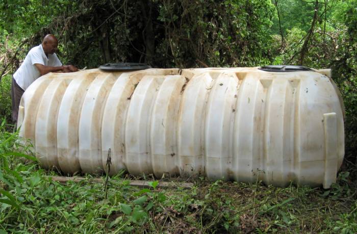

At the end of the summer, we have this tank that floated in to dispose of. Picture attached.
Ralph
