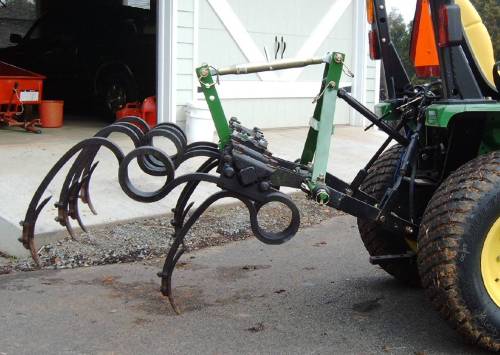

Using your box blade on edge to break up the garden soil before rototilling might be a good way to get down below the hard pan. Another thing to get might be a toothbar on your FEL; could rip the soil with it on edge. Or, if you happen to see an ad or hear about an old soil ripper, they would get down around 6 or so inches. Attached is a pic of mine that a friend gave me. They're basically little chisel plows, 7 of them. Cost me $75 in materials to convert it to a 3pt; my friend did this after I bought the materials at TSC. A 3 pt rototiller will run you about $1100 for a new one. Might check around for used ones, but check them carefully before buying.

If your tractor is at least about 35 hp, you might want to look at some bed hillers to make raised rows. Some are at this site: http://www.buctraco.com. I'm looking into just getting a couple of disc hillers from them and clamping them onto the 2x2 bar in place of the chisels on my soil ripper. Trying to figure out what clamps I need for it. They have the best prices on the disc hillers than a couple other places I've looked. Think I can create raised rows on my little JD with two of these mounted right behind the tires.

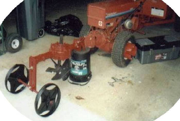

Wish I could figure out a way to convert a couple Gravely rotary plows to mount on the 3 pt to do raised rows. They'll do it without much hp required. No one seems to make them. BCS makes a look-alike, but no one makes them for the 3 pt.

For those who haven't seen a Gravely rotary plow, here's a pic.
It's not mounted on the tractor in this pic. The end that does mount on the PTO is sitting on that black bucket.
