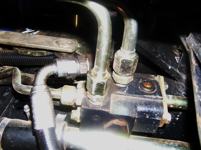

Ok, i've had and enjoyed my 758c, but since -- i have added two rear remotes and a from remote. now i don't know where to attach my back hoe as the PB port is gone.. do i just run a tee at that point (probably) ? thx

Yea, i put a front remote on for my grapple.. here are two pics, one is the valve block for the front remote and the other is the manifold under the right side of the tractor as is is now.. thx

   / suggestions on ATTACHING my backhoe? #4
Tim,
How did your backhoe attach before the front remote?
I'm currently working a "front remote" or third funtion for my FEL also. Very similar to yours, but with a different valve.
The line now coming from the FEL joystick valve, port marked "PB" (power beyond), is now the pressure going to your third function valve. Port probably marked "P" (pressure). Most third function valves don't have PB ports. So the outlet of the third function valve will be 'R" (return) or "T" (tank) this will feed the next valve in line in a open center hydraulic system. Which will be the inlet of the hydraulic block pressurizing the remotes and the 3 pont hitch.
I believe what needs to happen is the line going from your "front remote" back to the hydraulic module block needs a quick connect in it to attach to the backhoe. That's how mine will be plumbed.
Good Pics....

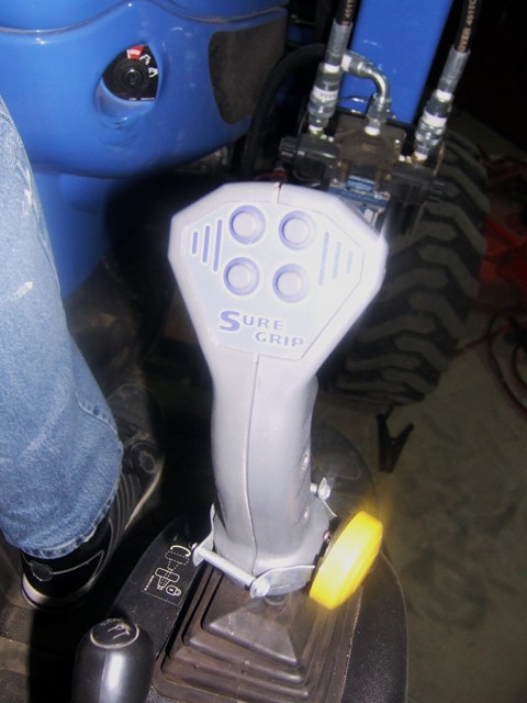

What kind of switch are you using to control the 'front remote" third function valve.
Hope this helps.

anyway, here's how i control my front remote ;) the left buttons are STILL the rabbit/turtle, the right are for the double acting cylinder..
also, i added a HORN because my children don't seem to pay enough attention to me when i back up, etc...
