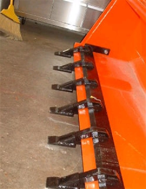

I had a Woods toothbar on my last tractor and it worked good. On my current tractor I went with a Markham because the leadtime was shorter and it was cheaper. It is just as good as the Woods one that I had. I will use Markham again on my next tractor, no question.

I've a Markham, really easy to put on and to take off. The assembly just slips over the edge of the bucket and bolts in place with 2 large bolts in the side of the bucket.
