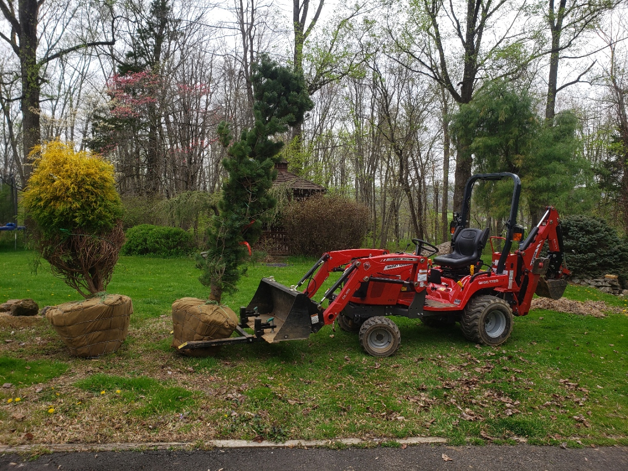

the bush on the left was about 600lbs. Just tilted back towards bucket to lift.
Get the SSQA forks, short and moveable and you will be amazed what you can lift closer to the "pins"
Move the 600lbs 2 feet in and probably get 800-900 lift.
I have clamp ons due to cost and need to be carefull not to bend the bucket while moving.
