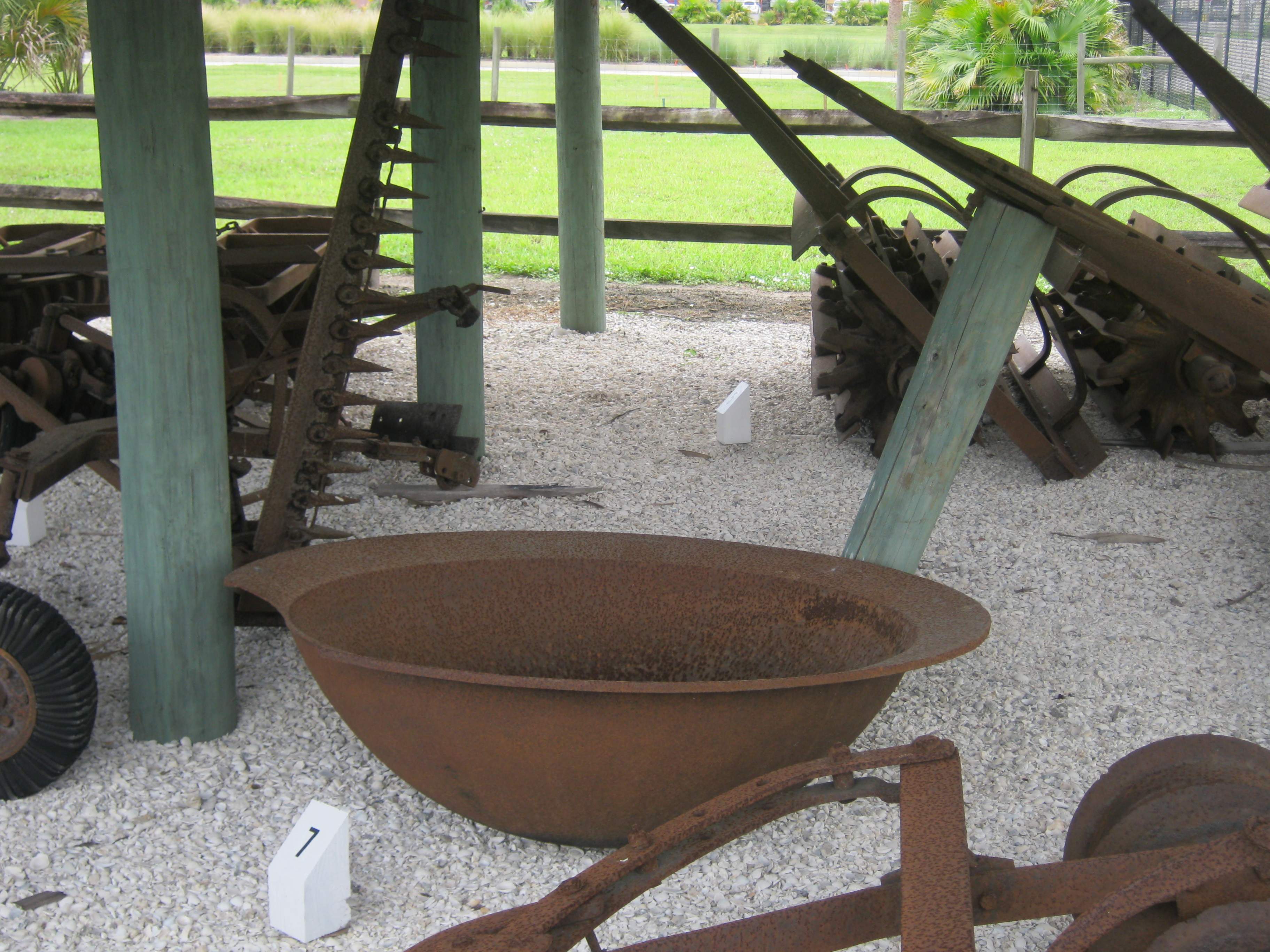

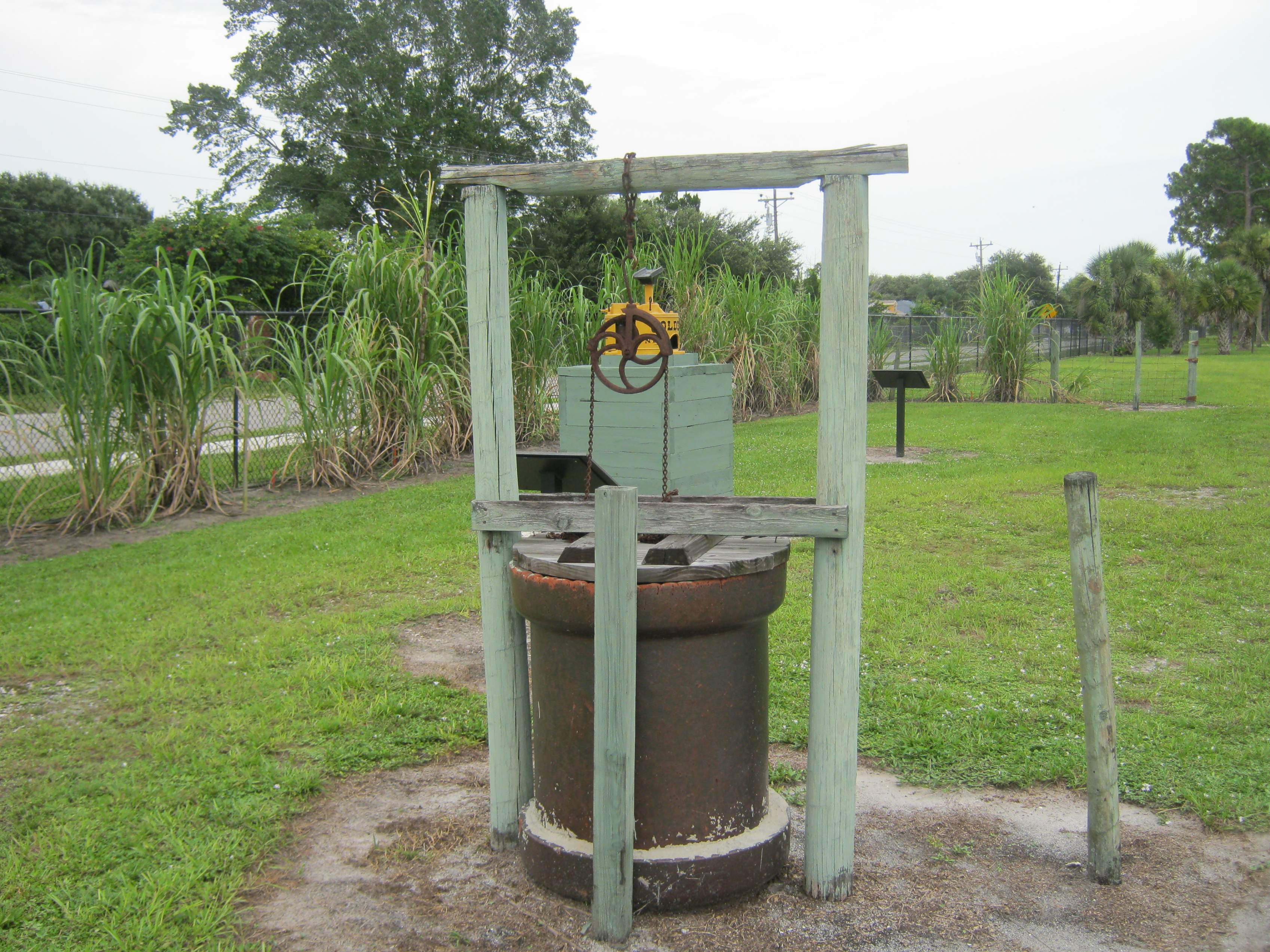

CJ don't want to get off track from your original question,but here is what I believe to be pics I took from vintage farm museum about 25 miles north of me.
Boone
sugar cane press/boiler ? :confused2:
