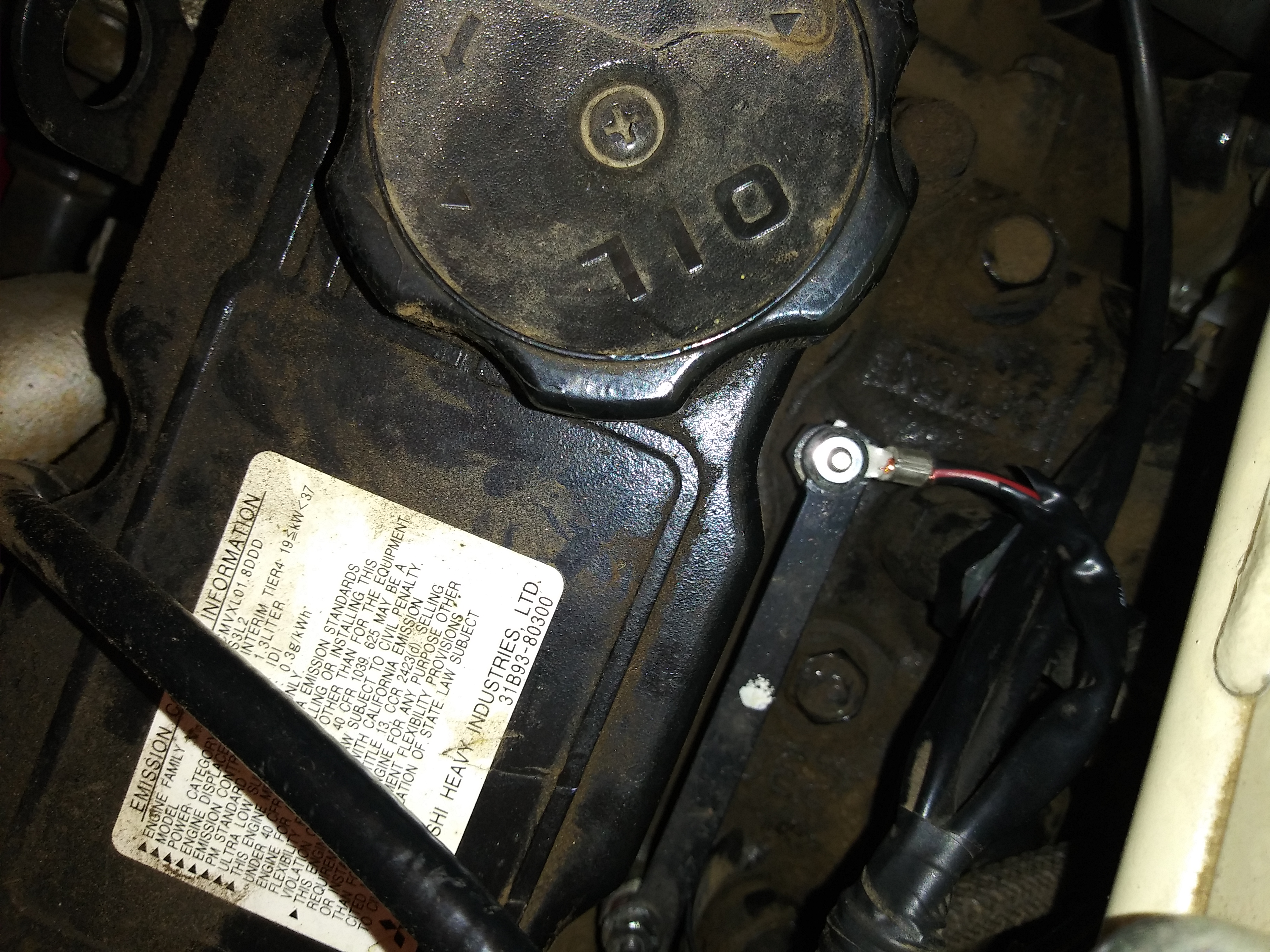

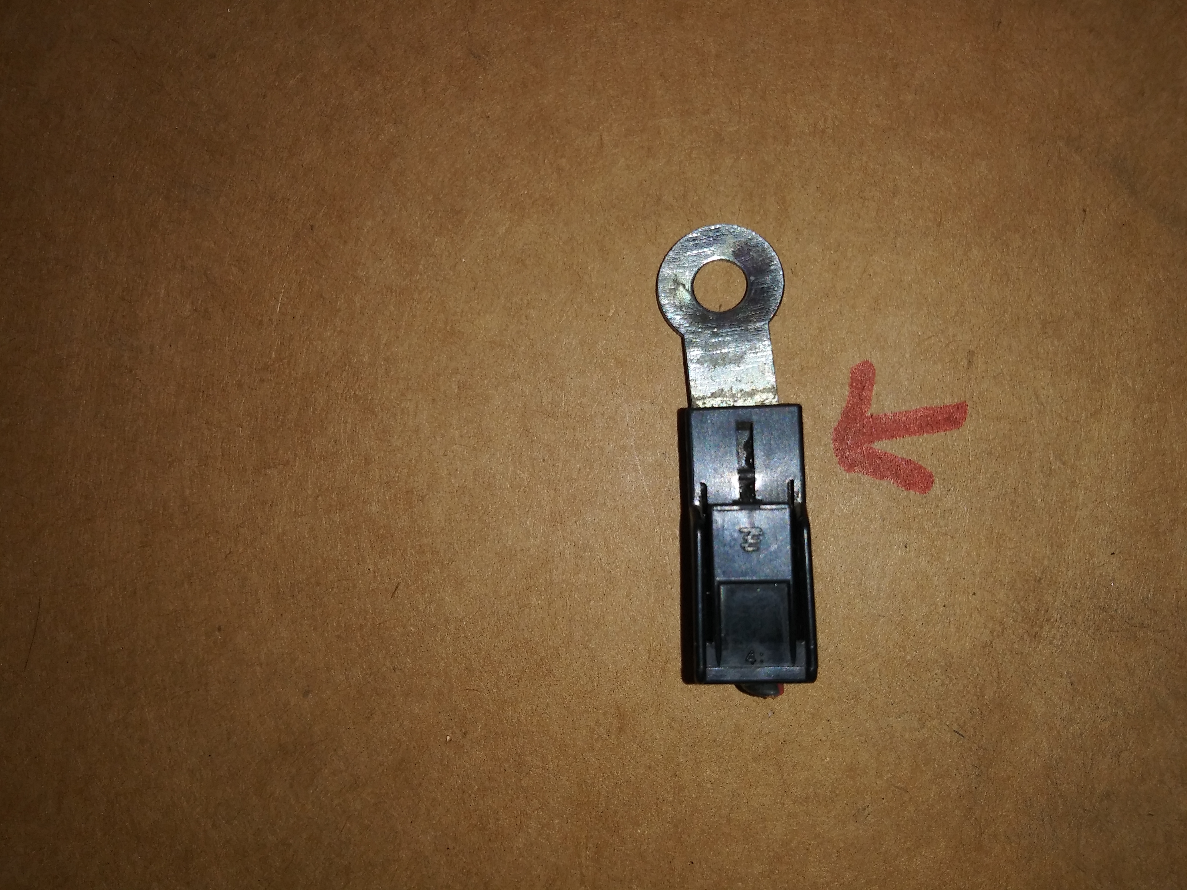

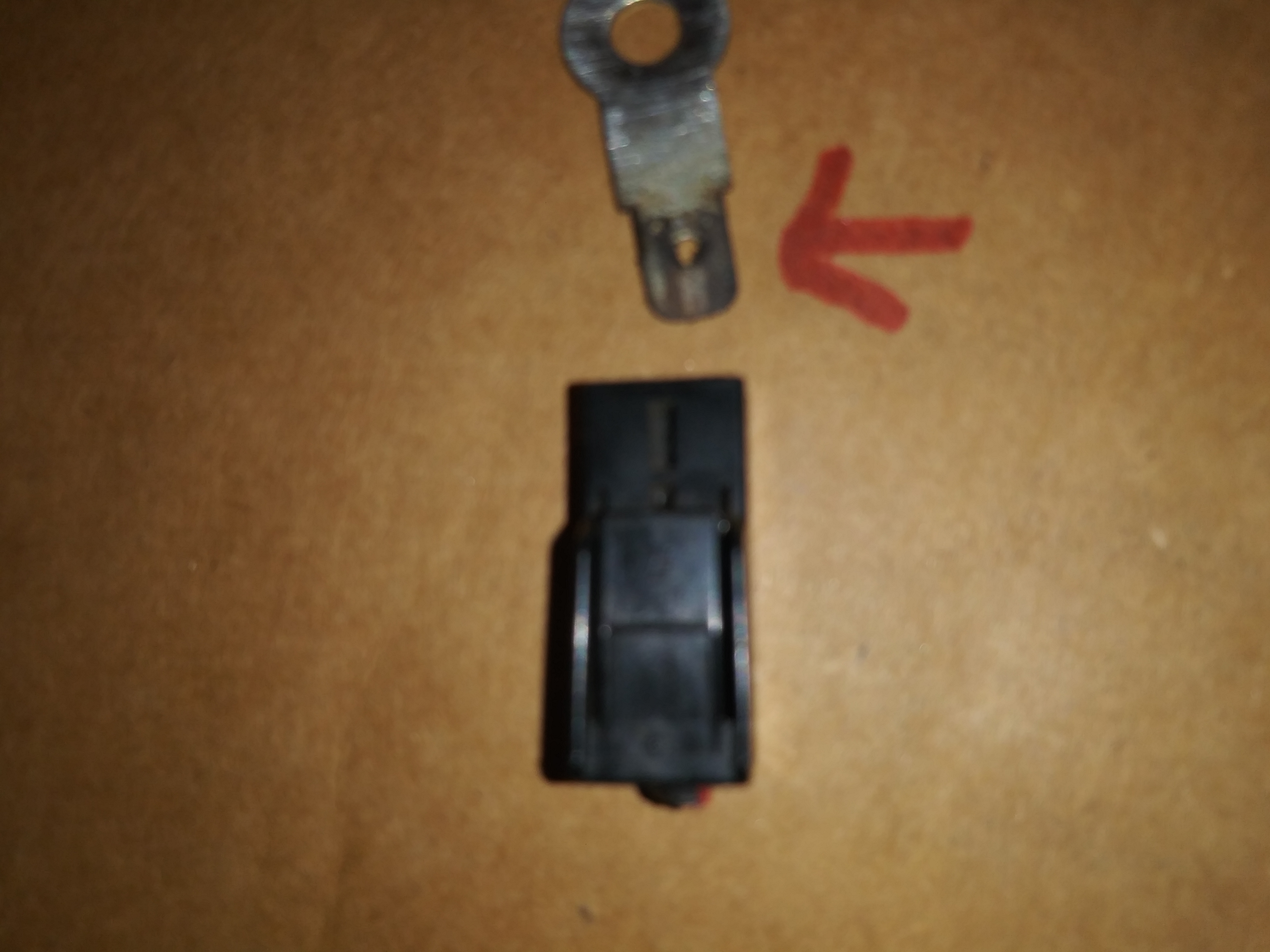

I recently had the same problem and after reading mike69440's reply I checked my GP power connection and cleaned it up and it still didn't start. At that point I called in my dealer's diesel mechanic and he had it running in 15 minutes. It was a corroded connector, just not where you could see it. He cut the factory connector off and put a plain ring connector on. He then took the factory connector apart to show me the problem and said it can take years for it ti happen but usually does. I've attached some photos, hope this helps. 20191014_141331.jpg20191014_141308.jpg20191014_141058.jpg

I recently had the same problem and after reading mike69440's reply I checked my GP power connection and cleaned it up and it still didn't start. At that point I called in my dealer's diesel mechanic and he had it running in 15 minutes. It was a corroded connector, just not where you could see it. He cut the factory connector off and put a plain ring connector on. He then took the factory connector apart to show me the problem and said it can take years for it ti happen but usually does. I've attached some photos, hope this helps.View attachment 624973View attachment 624972View attachment 624971
Thanks for this information, I had the same problem. Nine years of trouble free service 'til now. Was able to purchase a ring connector and fix it myself. Started right up perfect like it always did before. What a weird failure, never would have figured it out myself. . .
