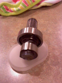

   / Sudden clunking/blue smoke diagnosis #9
I have 357 hours on my 2007 Kioti CK20HST with a FEL & BH. I had a similar problem about a week ago. I was moving some dirt with the FEL and started to notice a few puffs of blue smoke. Within 2 minutes it was a constant stream of blue smoke from the exhaust along with the engine running rough like it was missing on 1 cylinder.
I loaded the tractor on the trailer to take it back to the dealer the next day. Come to find out the warranty ran out less than a month ago. They changed the fuel pump (didn't fix it). After a few minutes of running, it cleared up instantly and the engine smoothed out.
Thinking the problem was fixed, they went to raise the FEL and nothing happened. No hydraulics at all. Dealer told me I needed a new hydraulic pump. So taking their advice I ordered a new hydraulic pump, but opted to change it myself ($300+ for labor, no thanks).
After I got home I pulled the old pump. However, it appears the old pump is just fine. So I started looking into the gearbox the pump mounts to. When you crank the engine, the gears do not turn. So I pulled off the gearbox and found the shaft that drives the gearbox for the hydraulic pump sheared. This shaft also has what appears to be lobes for the fuel injectors. I'm not sure as to what this shaft is called. Now things are starting to make sense.
This is what I'm thinking happened... The shaft had a defect in it which caused it to slowly crack over time. Eventually it cracked enough that the shaft started twisting causing the injection timing to be off for the aft cylinder (reason for blue smoke and rough running engine). Finally when the shaft failed (torsional failure), the aft cylinder no longer was getting fuel (no more smoke & engine smoothed out) and the hydraulics stopped working.
One other thing I have noticed over the past few months is the my tractor seemed to be loosing power while driving and operating the FEL & BH. I never thought anything of it until now.
Tomorrow I'll be taking my broken parts to the dealer to try and order a replacement. I'm afraid this is going to be easy or cheap. I'll post more later.
   / Sudden clunking/blue smoke diagnosis #10
Here is a picture of the section of the shaft that sheared off. The splines connect to the gearbox that goes to the hydraulic pump.
