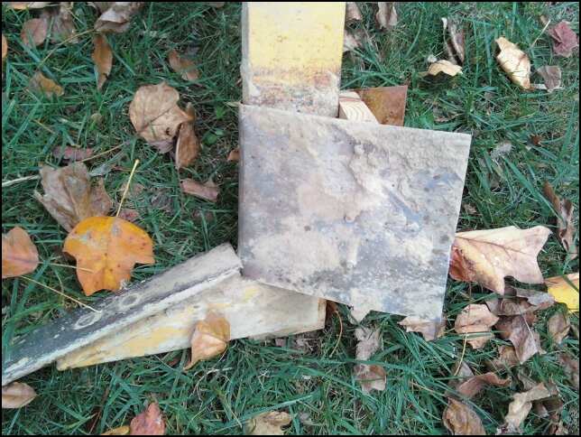

OK, I'm going to ask.
Has anyone ever modified (add a V-type wing) to a single shank sub soiler (Fred Cain) to open a 3" trench to plant pine tree seedlings?:rolleyes:
Heavy soils, norhtern Wisconsin application, about 1,000 seedlings.
I'm listening to advice, perhaps I have the wrong implement idea for the job.:confused:

I used the 1 row subsoiler to plant trees with. I ran contours with the hill side and had to add some weight to the subsoiler and hit it twice but it did a nice job and the trench catches water nicely.
   / Subsoler / Seeling Planter #5
I Tried the KK single plow to plant 100 seedlings in heavy clay soil. The plow was over kill and left mostly large clods with no loose dirt to pull up around the seedlings. I then used the sub-soiler, did a much nicer job. Didn't tear up so much, fewer clods and left more loose soil to pack around the seedlings. In the heavy clay I have I had to add weight to the sub-soiler and go over the area twice.
   / Subsoler / Seeling Planter #6
I have a united Middle buster/ subsoiler made by United. you can change the heads to go between. A fellow called me at work the other day knowing I weld on the side and asked about making such. He had a similar plow MB so I unbolted the foot and bought one for a subsoiler at United. Then on top of that I weled a set of 5/16 by 3 inch plated formed in a V shpe with the point facing forward. and added and arm to the top of that to run a 14 inch coulter wheel to slice the sod.. The coulter will dig in fisrt slicing the sod and the blade will pull it down. and the v will push back the sides and leave a pressed clear cavity for the seeedling. I think that it could use a sharper longer V and leave off the sub soiler tip. It would be alot more like a Holland planter then. They use a small sod roller to pac down the seedlings.

Apologies for the late bump on this topic, but I've been off the site for some time.....
FYI - I've been playing with this tree planter concept for some time now. I've gone from Dibble bars, to PHD's, to potato plows, etc.... Regarding the original poster's question, I've already tried the modified subsoiler with mixed results. My prototype (see pic) worked mostly "ok" in soil that I had disked and dragged to loosen it up. On sod it only opened up a small trench, and did not allow for any compression or compaction to close the opening.
I believe the design needs to be modified to become: 1) taller; 2) narrower; and 3) swept back further. The prototype would open up a gap but allowed too much soil to drop back into the cut, so I think the "wedge" needs to be adjusted to be narrower/taller which would allow me to place the evergreen seedlings (bare root) into the gap before the opening closed.
Some other additions I am considering are 1) coulter to cut sod; and 2) offset implement wheels/tires or a drag to close the planting cut back up once the seedling has been placed.....and yes if I just added a seat I might have a normal planter which you can buy - but what fun is that? Besides I don't want to spend $3-4k when I only plant about 1k of seedlings each Spring.
