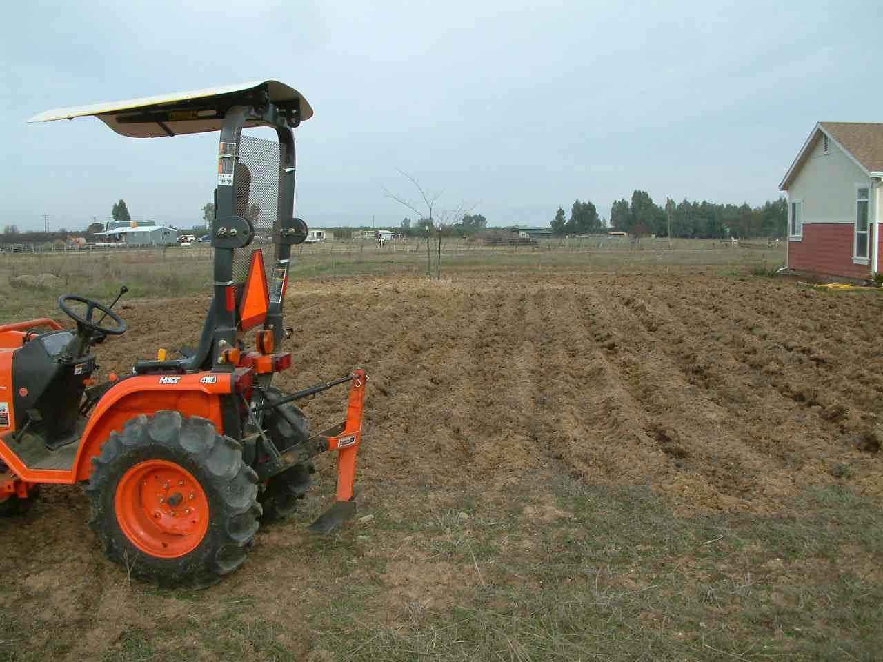

Use a middle buster (aka potato plow) for this job ($140 from Tractor Supply).
I did this plowing with the MB attached to my 2005 Kubota B7510HST (21 hp engine, 17 hp pto, 4WD, hydrostatic tranny). You can tell from the lack of mud on the tractor tires that the ground was fairly dry when I did this work.
