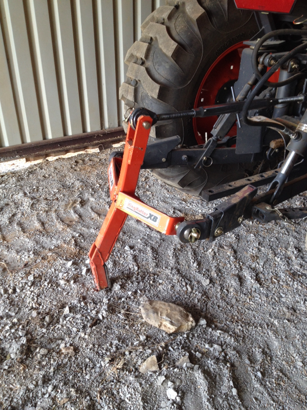

I have that sub soiler and have had to reinforce the it in the hitch area and have bent the shank into a ~3" "smile". All this with a Case-IH 385 (43 engine HP, 5000#) trying to cut roots around stumps. If you have a strong tractor you CAN tear it up.

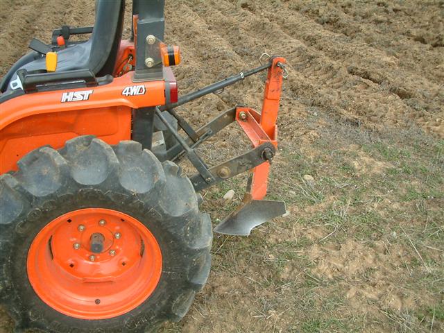

I used a King Kutter subsoiler (the $150 version from Tractor Supply) and my 2005 Kubota B7510HST to plow the soil around my place for landscaping when the house was built in 2005. Work was done in May an the end of the rainy season, so the soil was damp. No problem. Just took my time so nothing would break.
Good luck

If it starts to look like this, stop.
