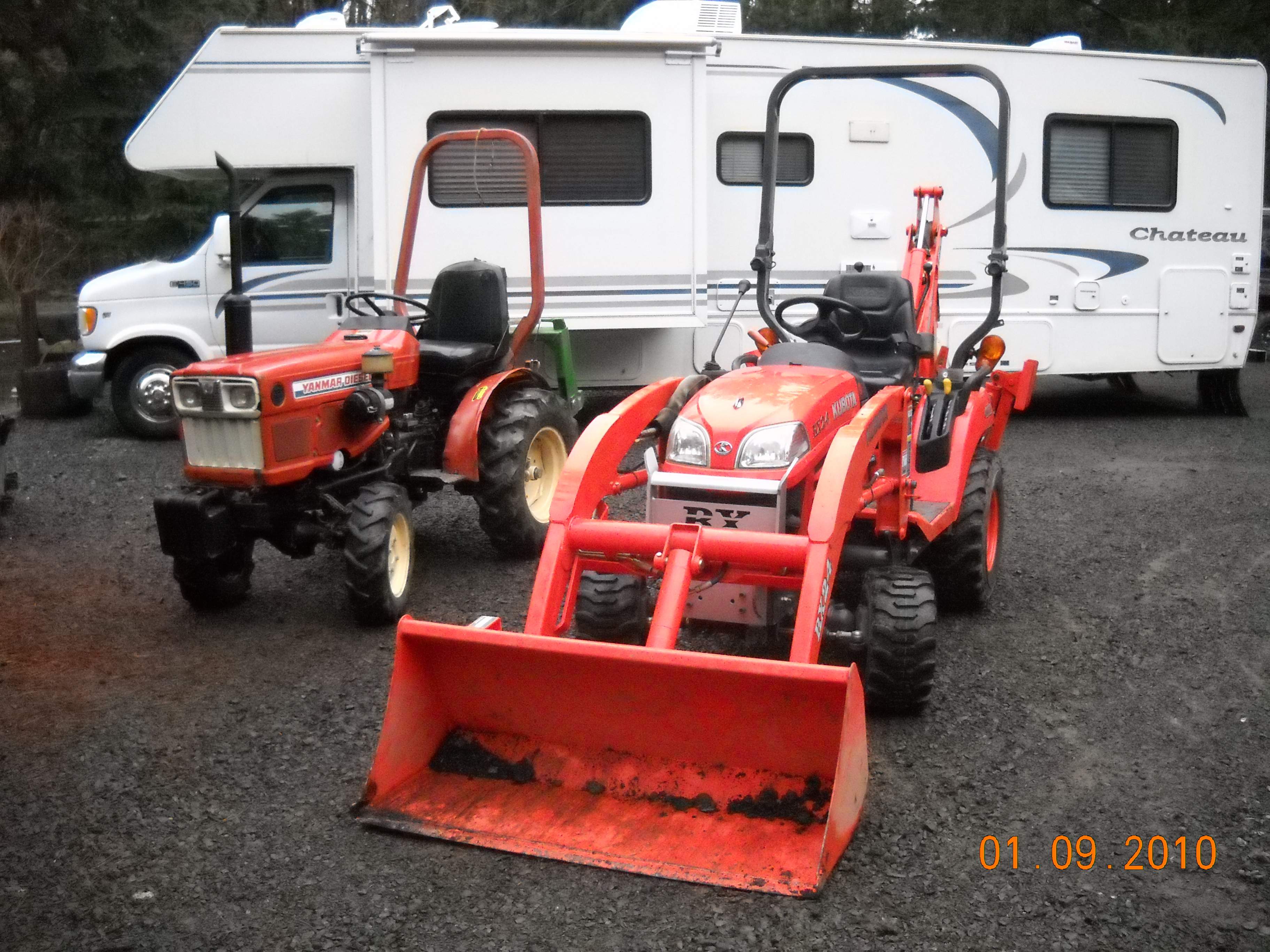

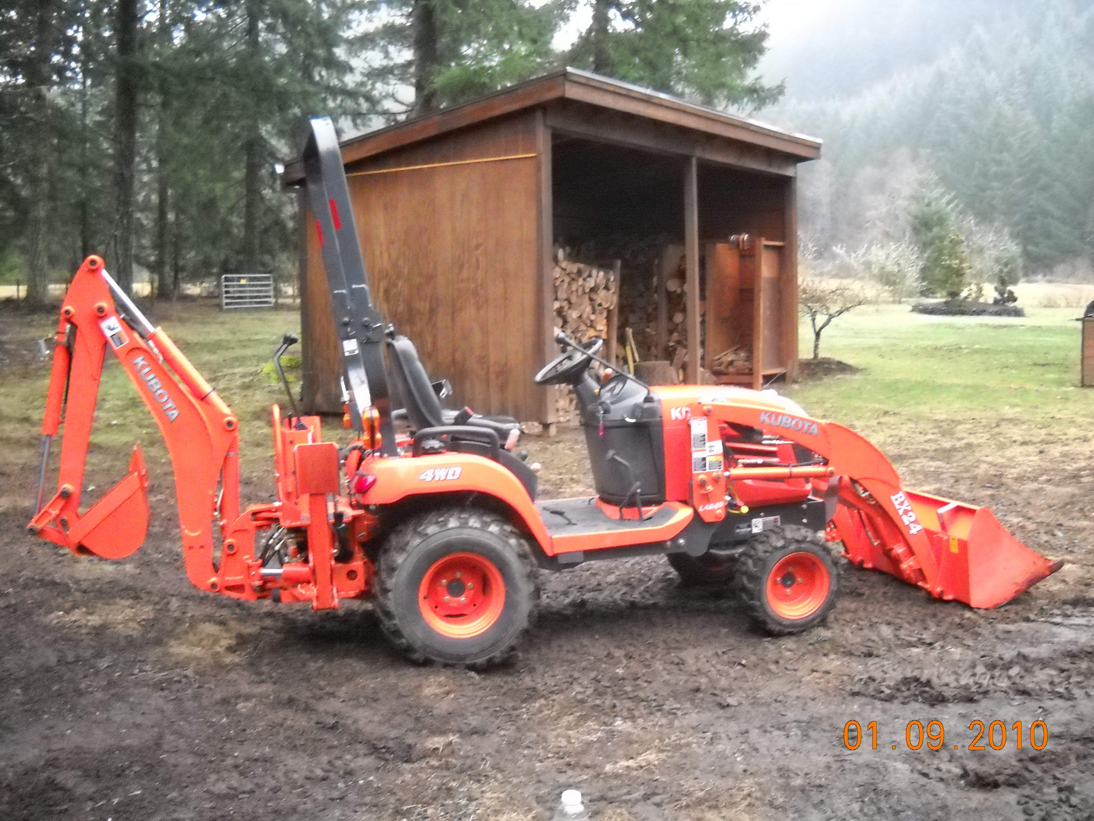

:welcome: to TBN!:thumbsup: Are you thinking like a BX series Kubota or JohnDeere 2210-2305? My neighbor has a Kubota BX24 and it is a good little tractor. If you are planning for working on rough terrain though, i'd look at the next size up which would be a kubota B2320 or a JohnDeere 2320. I have a 19 hp Yanmar 169D and it works for what i use it for but i do plan to upgrade to a larger machine soon. With the gray market yanmars, it may be hard to find parts on certain models and easy on others. Luckly, my yanmar has a fair amount of parts availability but some parts are still hard to find. I guess some key questions are, what is your price range, what dealers are near you?
