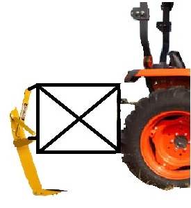

So, I just tried to do this, the problem is that the ripper tooth is too close to the tractor and not close to the tree. With your larger MX tires, I'm assuming yours would be also. BTW, I have both of the rippers shown below: You would destroy the first one.
3 Point Subsoiler-Subsoiler Attachment | Agri Supply #7341?
Single Row Subsoiler 3-Point | Agri Supply 58333
The second one will stop your tractor... it doesn't have a shear bolt but it jack-knifes. Bends in the middle in theory - although, I've never had that happen... it just stops my little tractor. I bought the Fred Cain subsoiler used for $100 and honestly, it too big for my tractor.
SO, my plan is to try and build a metal frame to move the subsoiler back away from the rear of the tractor... not sure how it will turn out. Just thinking about it...
