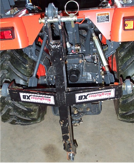

I bought a KK XB sub-soiler/middlebuster a few months ago. I was very disappointed with the quality of the unit.
Had to spread the yoke where the top link attaches
Bad paints runs and unpainted areas (a KK trademark)
Poor weld joints
KK logos installed upside down
Bolts to hold the sub-soiler blade on were the wrong size
No backing plate to install the sub-soiler blade (I had to fab one)
I called KK to alert them to the quality issues but I could tell that they weren’t interested in quality issues. I wasn’t asking for money back nor was I interested in sending the unit back. I just wanted to let them know that they had some major quality problems.
On the positive side, I have used the sub-soiler to dig trenches to lay wire and it works fine. It is the correct size for my BX2200 3PH.

I've heard a lot of trouble specificaly out of the XB series from KK i bought a std. KK subsoiler and it seems to be welded good and fit perfect on top link. Is the kubota top link slightly wider than std? Is the XB for sub compacts?

shady1701...When I talked with the folks at KK they said that they used a Kubota BX2200 to design and test the XB implements. They said that they would look into the upperlink issue when they had some free time (that was months ago). The guy I talked to said they wern't selling a lot of XB product so XB problems don't have a high priority. When I mentioned that they installed their logos upside down he said "that's not the first time that has happened".
