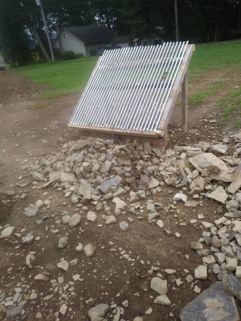

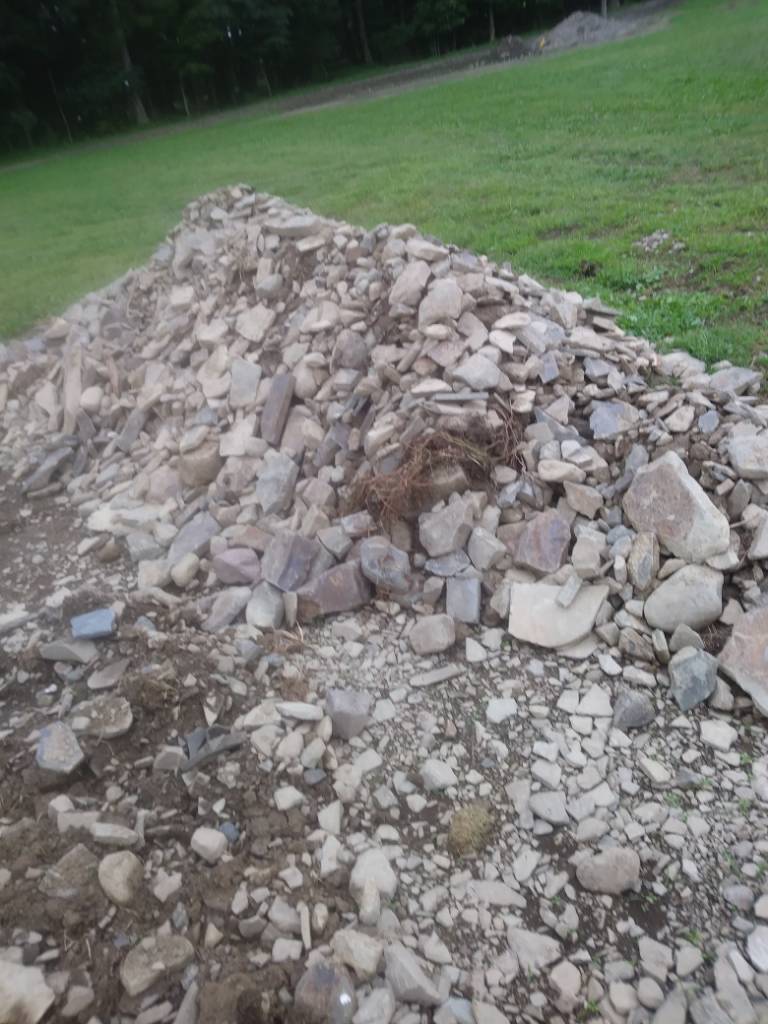

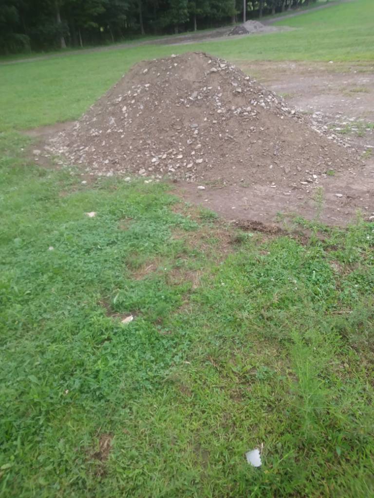

I decided to try building one, cost less than 100 bucks. Made from scrap 2x4 rough cut wood lagged together and 3/4 emt conduit and conduit clamps.
Works really well with the BX23S. Well worth my time/coin. 0901180853.jpeg0901180853b.jpeg0901180853a.jpeg

Nice, looks like it works great..
   / Sub compact rock separator #4
Looks great. I wish I had thought of that last spring when I had a bunch of dirt I dug up to make a driveway. I spread the dirt out to level the lawn then had to hand pick the rocks.

I have a large mound for a big project I have been keeping since we built the house it must be 30x70x4, lots of material to say the least. Its about a 50/50 mix of dirt to rock but its so hard to work with as is and separating it makes it useable. The rock I will use for a base on the driveway to the shop and the dirt now that I can easily grade it will get used in a bunch of projects. The separator does work pretty well and is holding up to the point where I will likely not need to build another.
