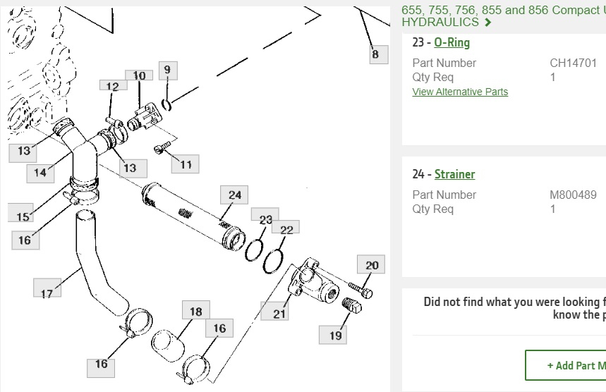

89 JD 755 compact tractor. Bought it from a man and he said it just quit pulling. It sat up for a while and the FEL,3 PT hitch and power steering didnt work. First thing I did was drained fluid and cleaned screen whith was very dirty. I put new low vis hi gard in and filter and I started tractor up.The FEL ,power steering and 3pt hitch worked fine but it still would not go backward or fwd.From what I understand the pump sucks the oil up through the suction line and into the hydrostat transmission? I broke the line loose where it connects the the hydrostat and there was not oil in the line.But my FEL and power steering works. Someone pls explain this and thanks in advance

Has the strainer been inspected and cleaned?
Part Number M800489

Looks like the 755 has a flow divider. Something is preventing the supply to the HST. Need a manual and gages to properly diagnose. My biggest concern would that the HST was run oil starved for a while. If the the cause of the oil stsrvstion was sudden, maybe no problem. HST charge pressure is on the order of 150psi.

I had a 755 and the hose #14 was sucking in air being cracked because of age.
