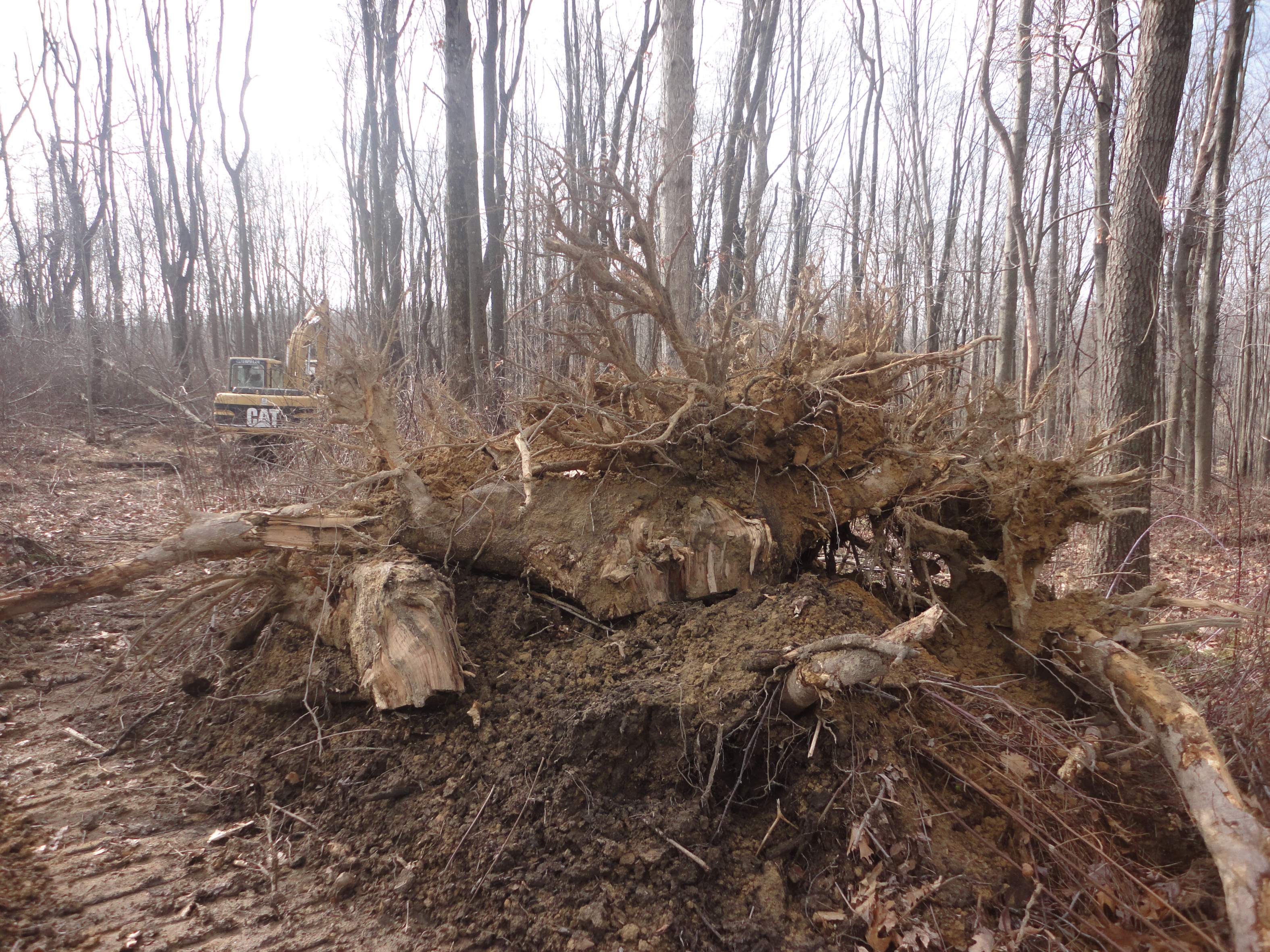

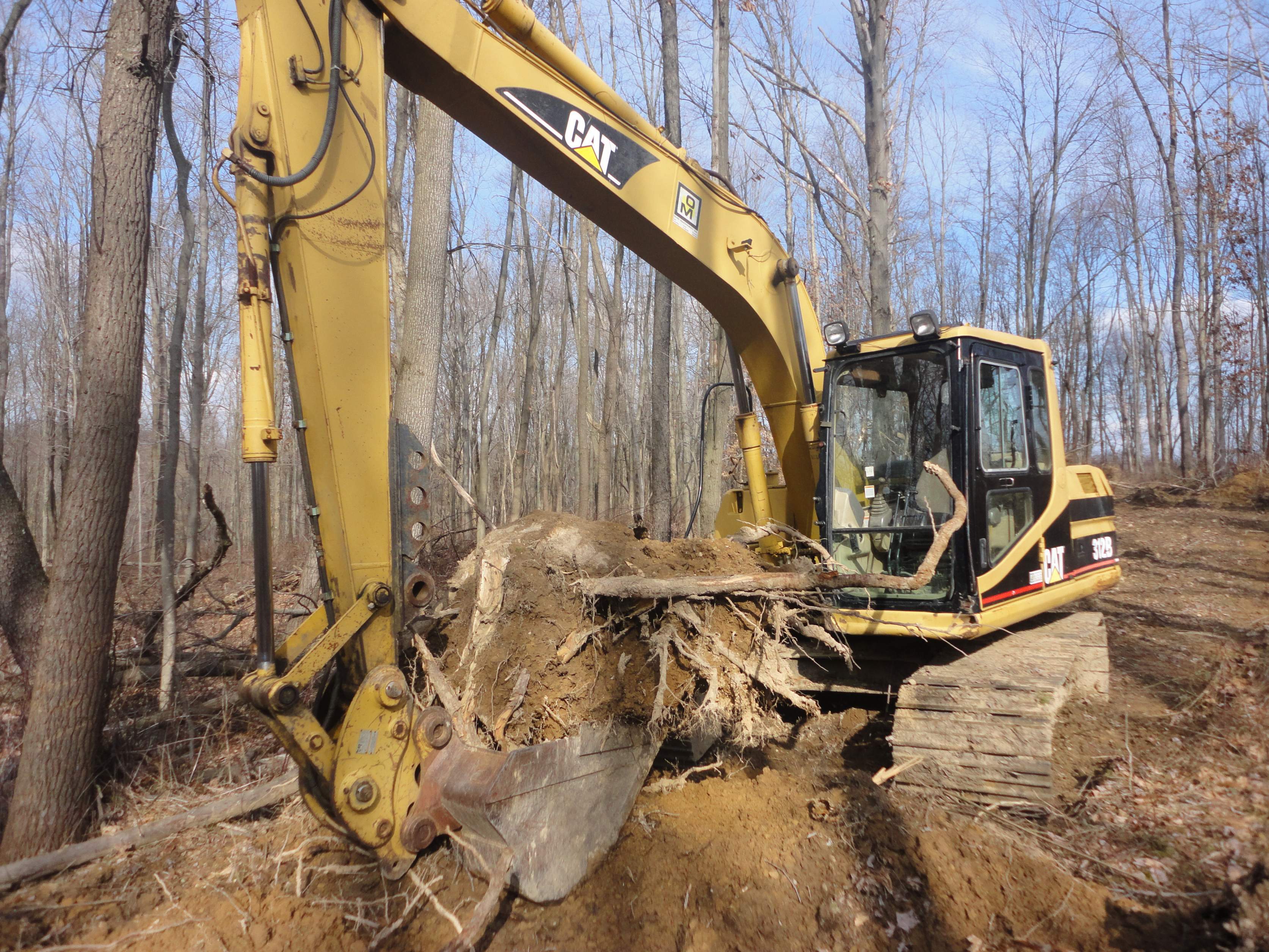

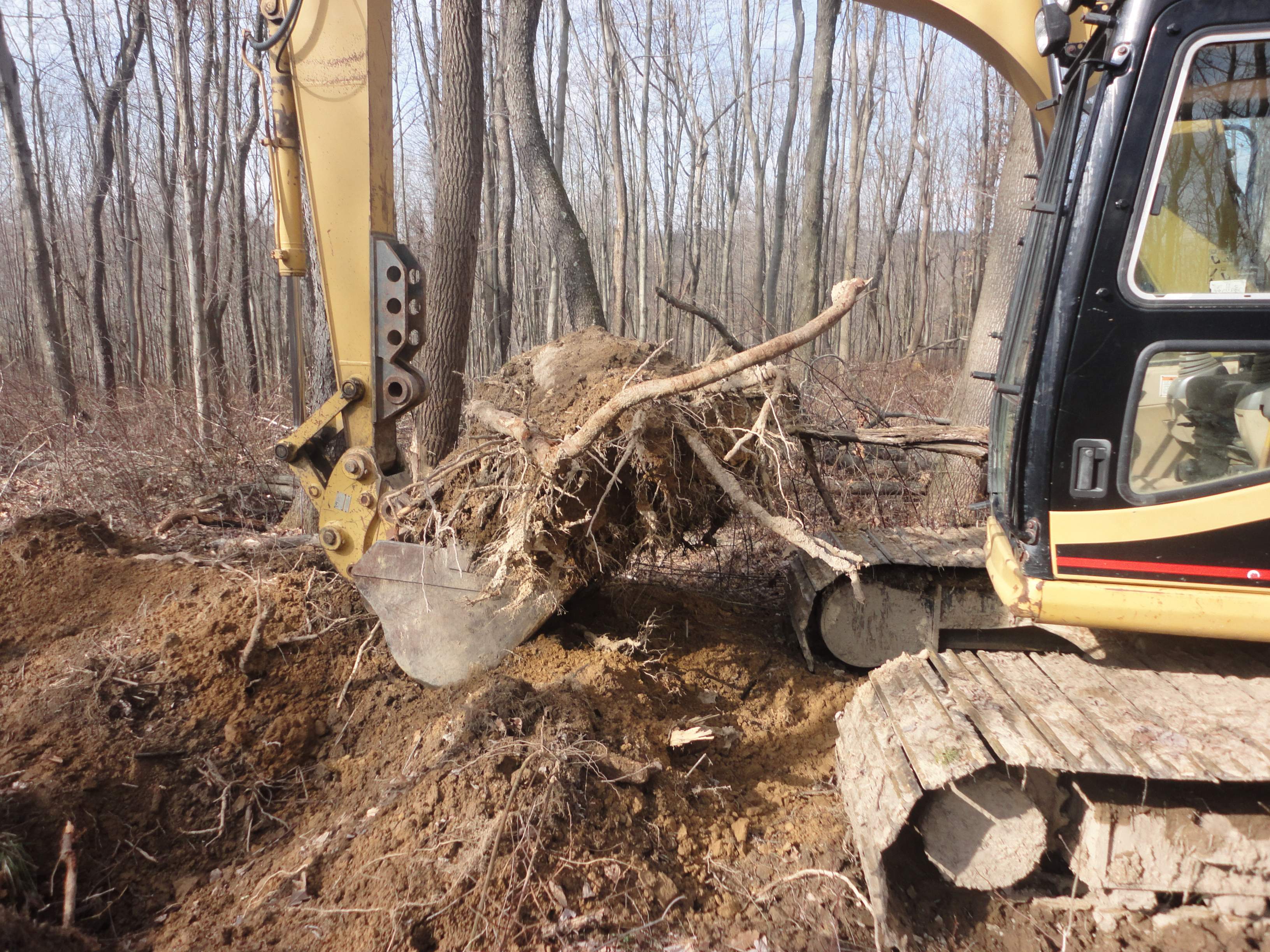

Thinking I should start a new reality show. I bought a 62 acre parcel that I call my "stump farm". The seller had it logged right before selling, stumps and tops all over the property.
I should sue him, he's costing me all kinds of money....I've had to buy a dozer, excavator, and now a tractor with a grapple to deal with the tops. Dam him!!!:laughing::cool::laughing:
Some of these stumps are taking me a few hours with a 14 ton excavator.....eish!

Be careful, I broke the stick on same size track hoe digging stumps one time. $7000 for a new stick!!!

true....the machine had a crack I had welded when I bought it, I think about that when I'm yankin on a stump, and let off before I stress something. Don't need no big repair bill.....

Scoutcub, did you ever consider grinding those stumps? One of the main benefits is about 90% less cleanup and no big holes to backfill. A Rayco C140 with a stumpgrinder or similar would eat the excavator time wise.
   / Stump Wars #8
If you don't go with a grinder get yourself a heavy duty grapple which can act like a shear to cut your way through the stumps.
