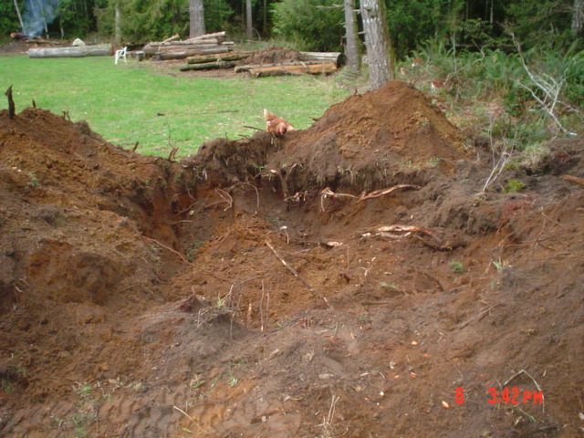

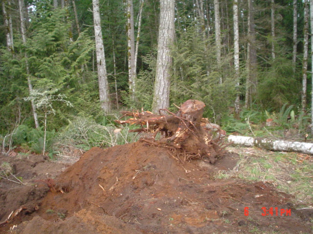

Dug out an 18 inch stump today. Ended up with a good size hole as I had to break the roots before I could get it out of the ground. Found a couple of times the front was lifting so think next time I will fill the loader with gravel for some counter weight. This should give the backhoe more force to break the roots.

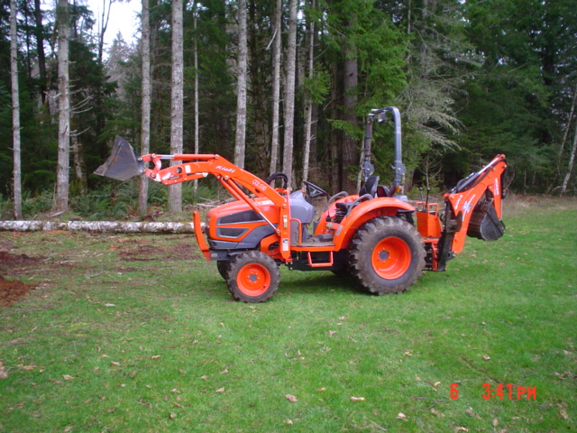

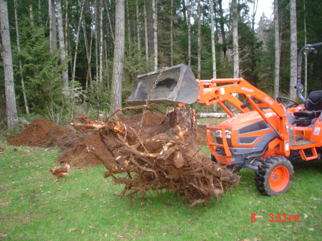

Had the backhoe on the back, this is what I dug the stump out with. Backhoe is heavy so makes a nice counter weight. It was an Alder stump 18 inches in diameter. Roots make it look bigger that is. Was really not that heavy, the loader lifted it no problem.

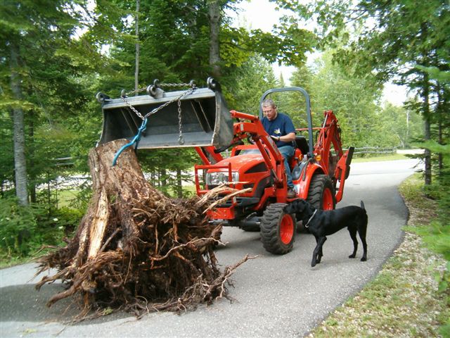

I hope we have not overdone it with oour cautioniing. If you have a stump to dig with that back hoe by all means Mousefield should attack it. These backhoes are not merely a big bunch of sissy attachments either. While I know it's not of the industrial variety, I have 450 hours on my CK20 and 200 hours of it was backhoe time mostly digging stumps.
Read all your manuals for the tractor and the attachments and practise safe common sense usage and put that thing to work. I don't really think you need to buy a backhoe and leave the rig parked as a monument. Use but no sense in abusing.
While I did not happen to see any warnings in the backhoe manual for loading the FEL bucket during usage I know it is abusing the unit to bounce the front end around while the tractor backhoe is under load too.
I know all who have responded here would agree common sense goes a long way with safe and capable operation.
