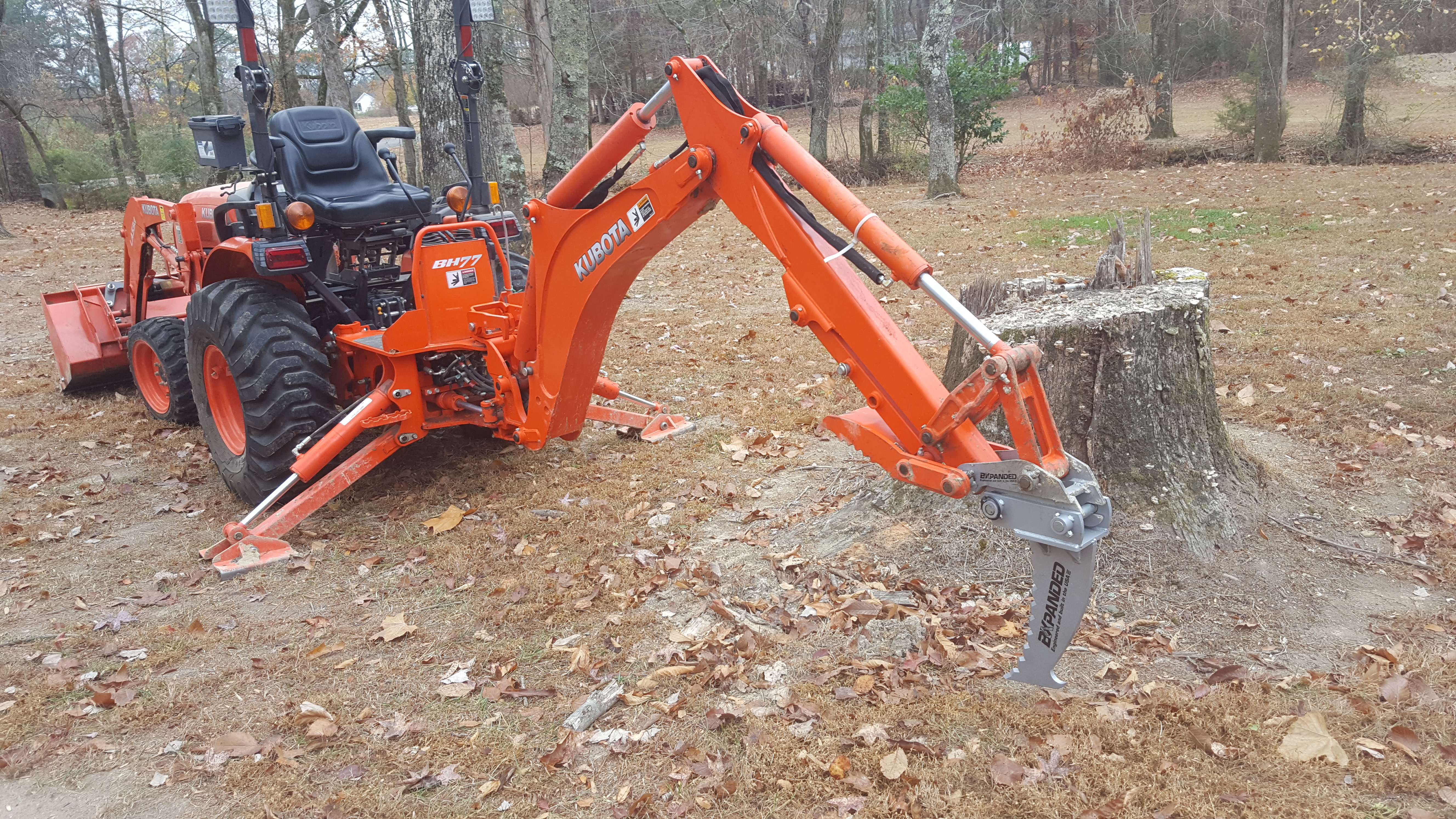

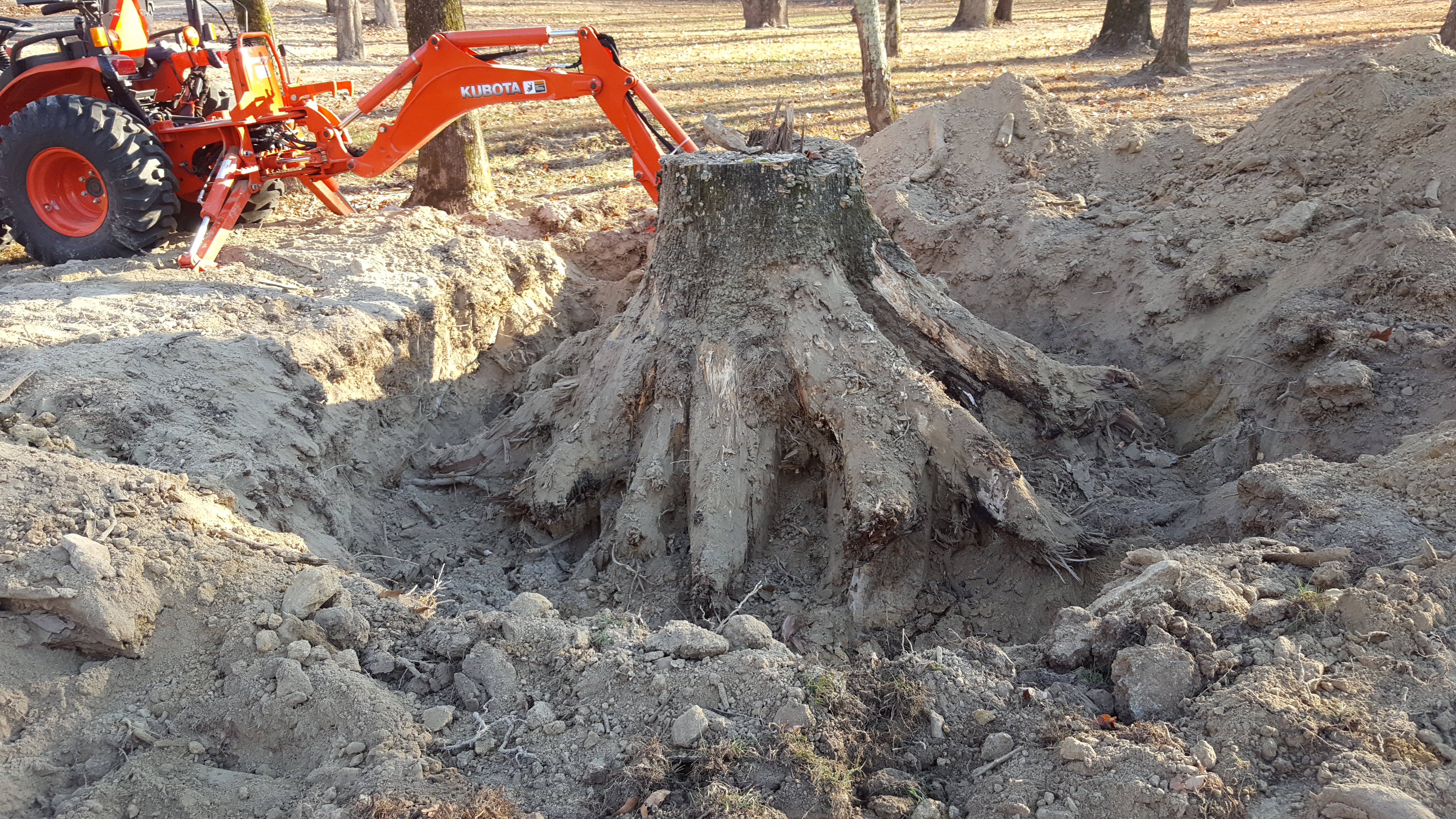

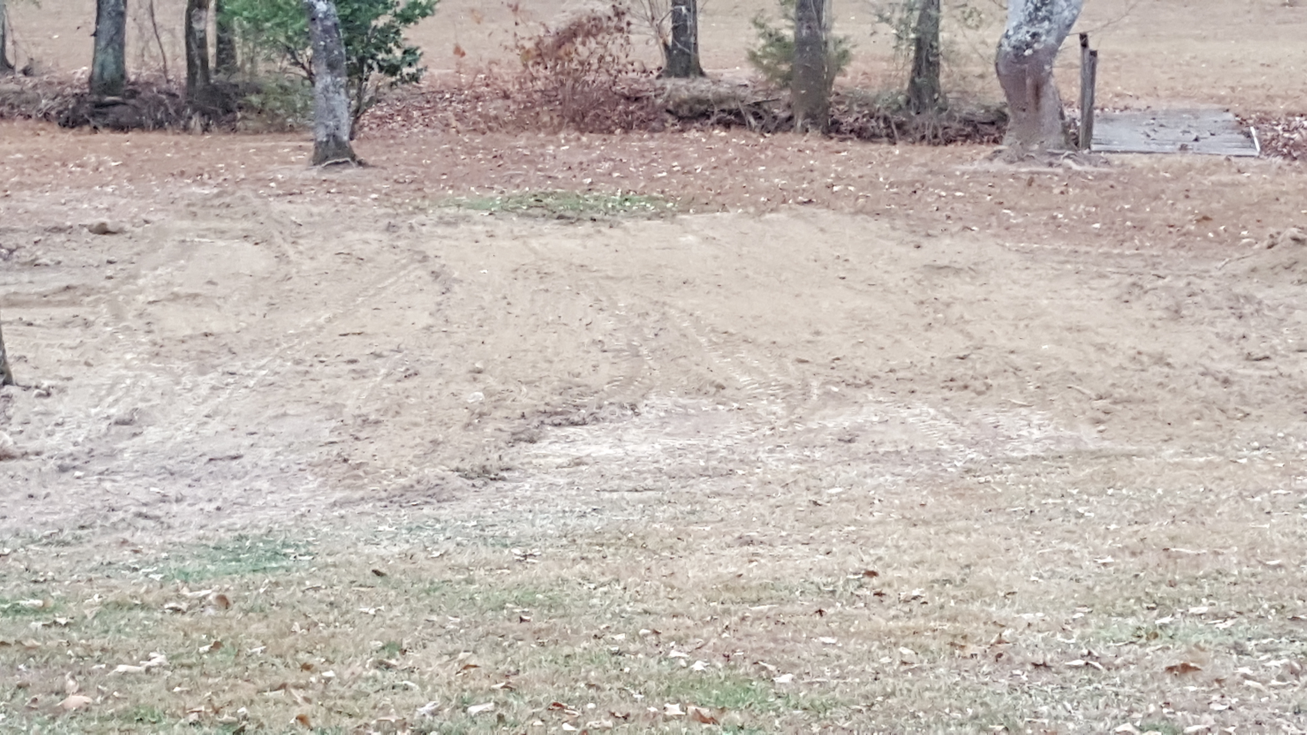

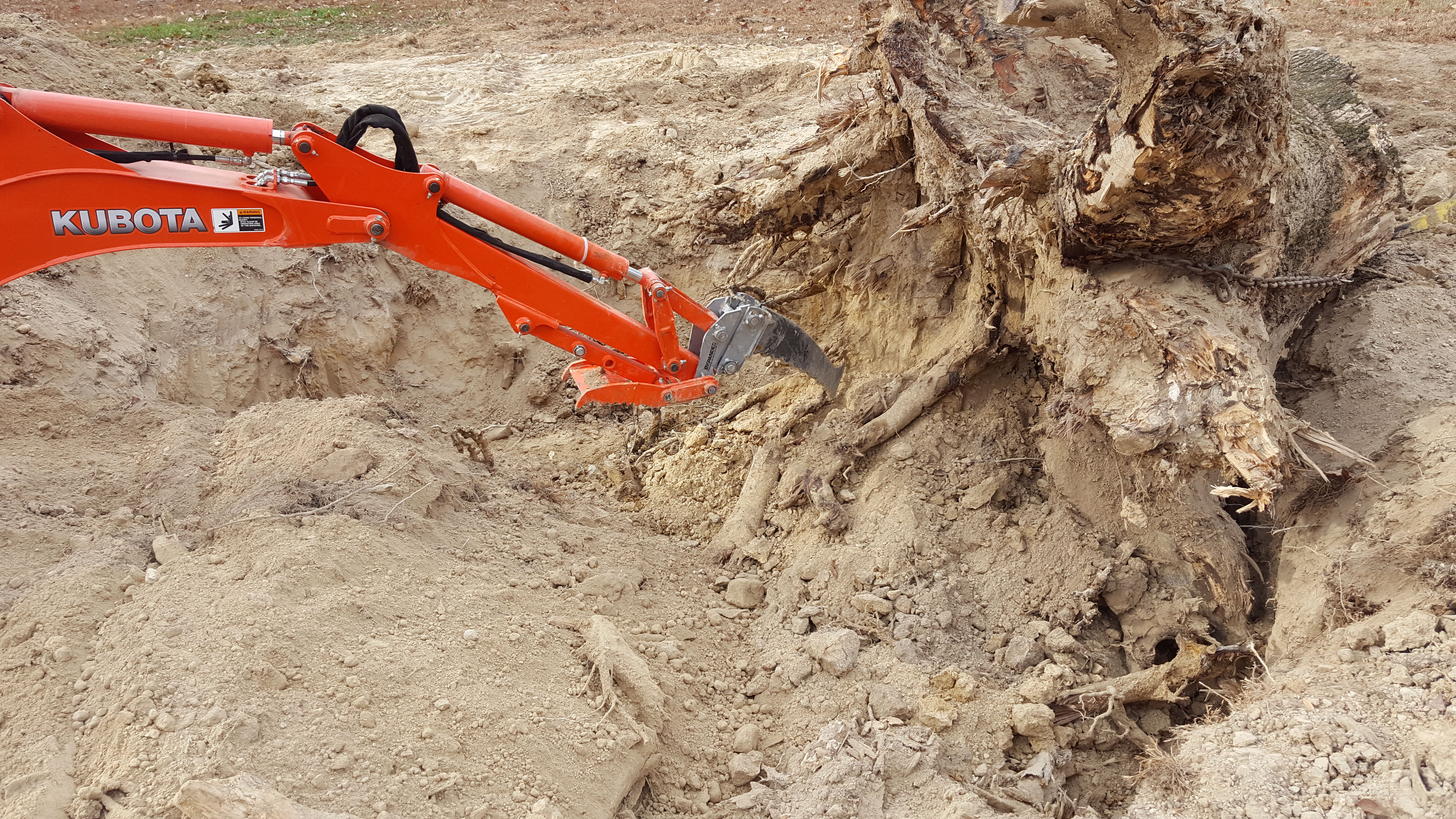

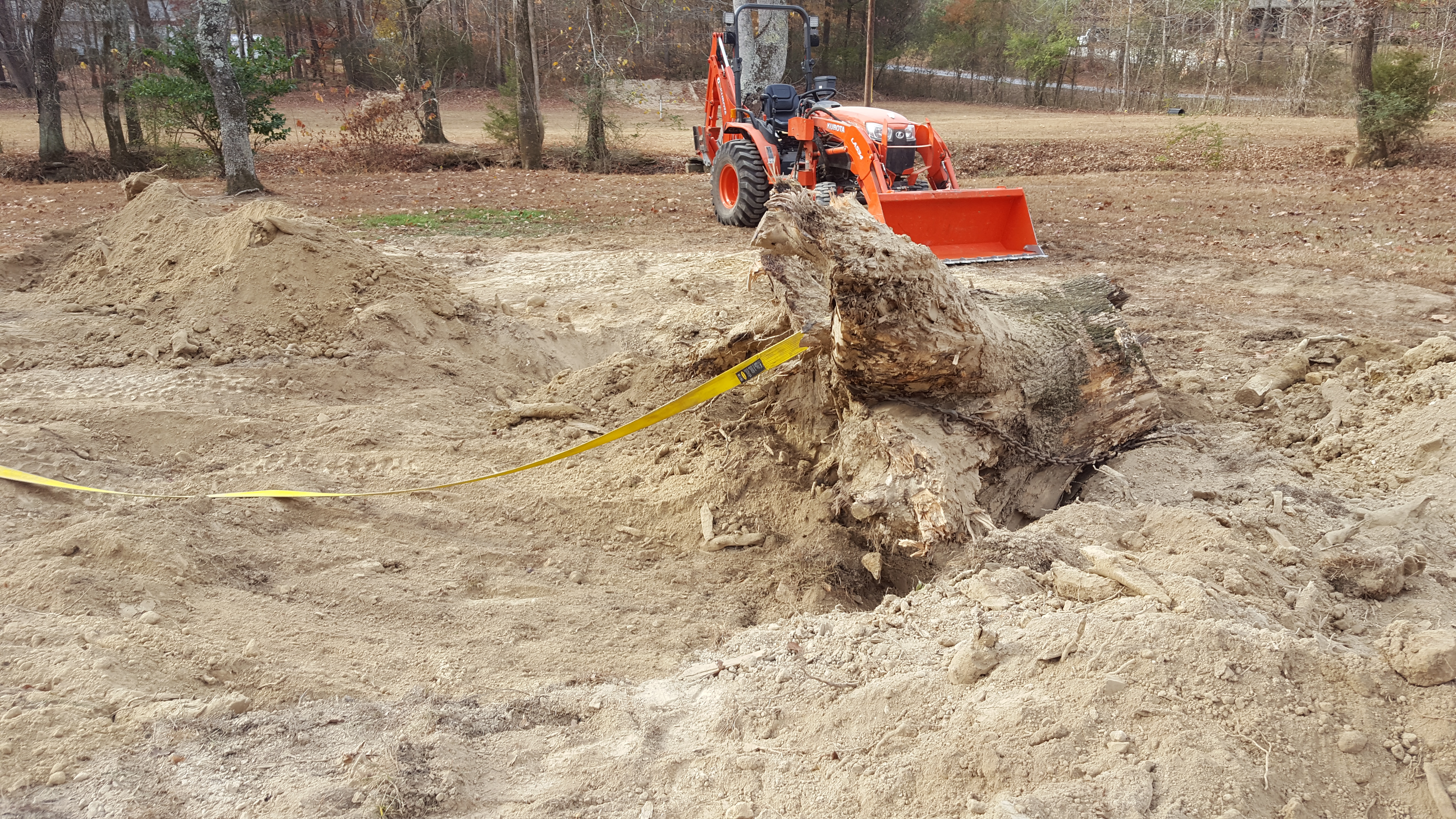

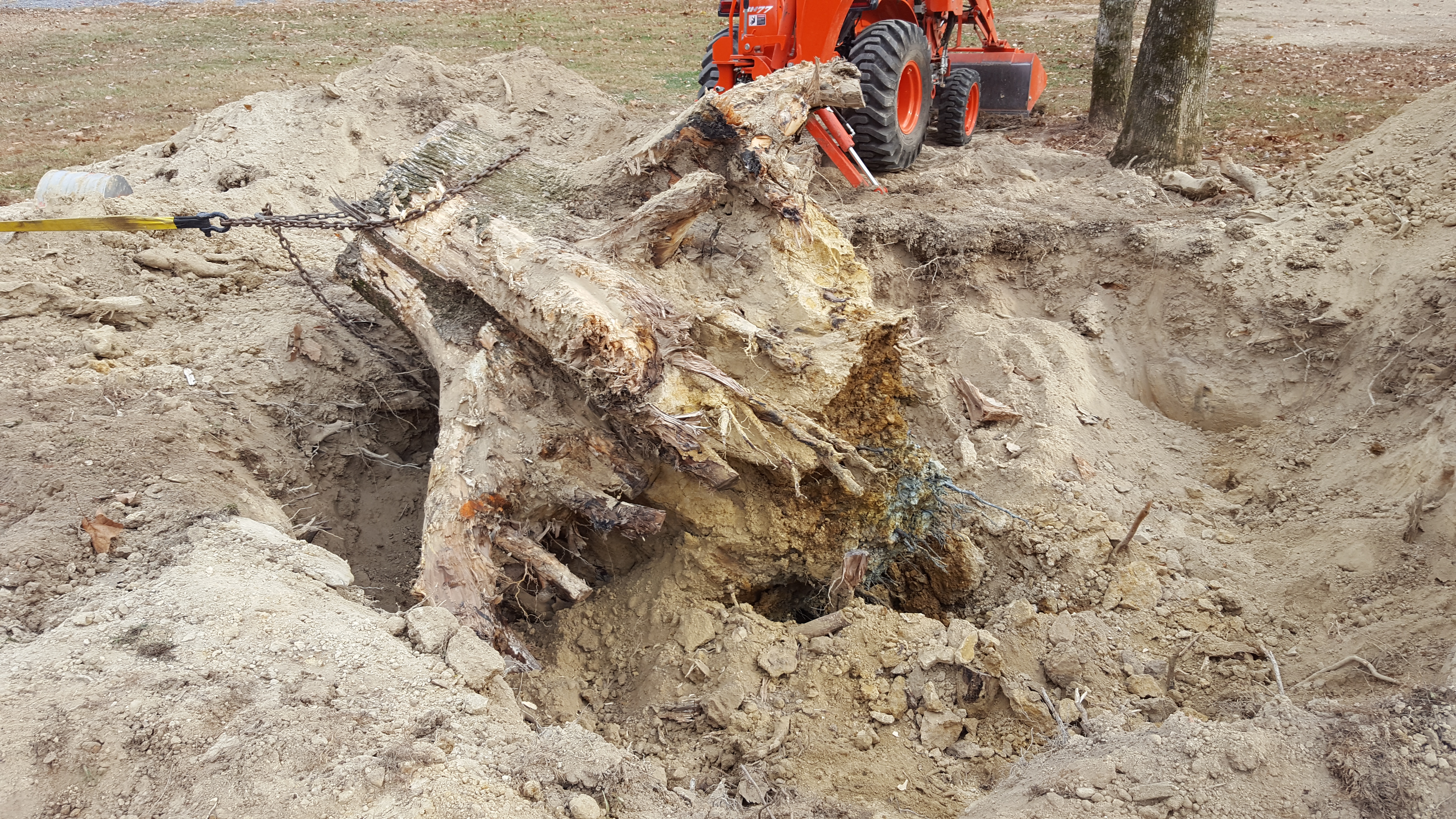

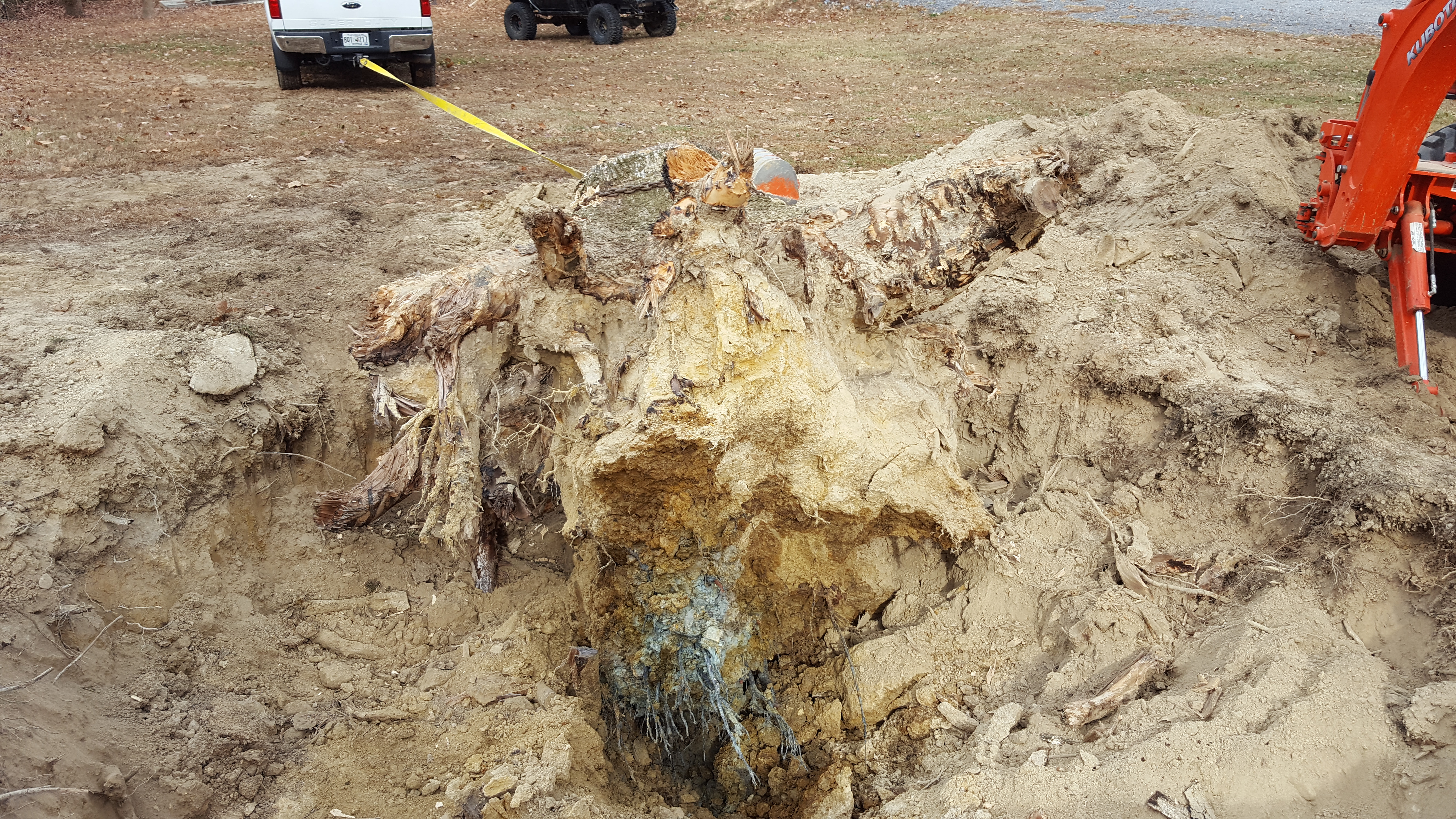

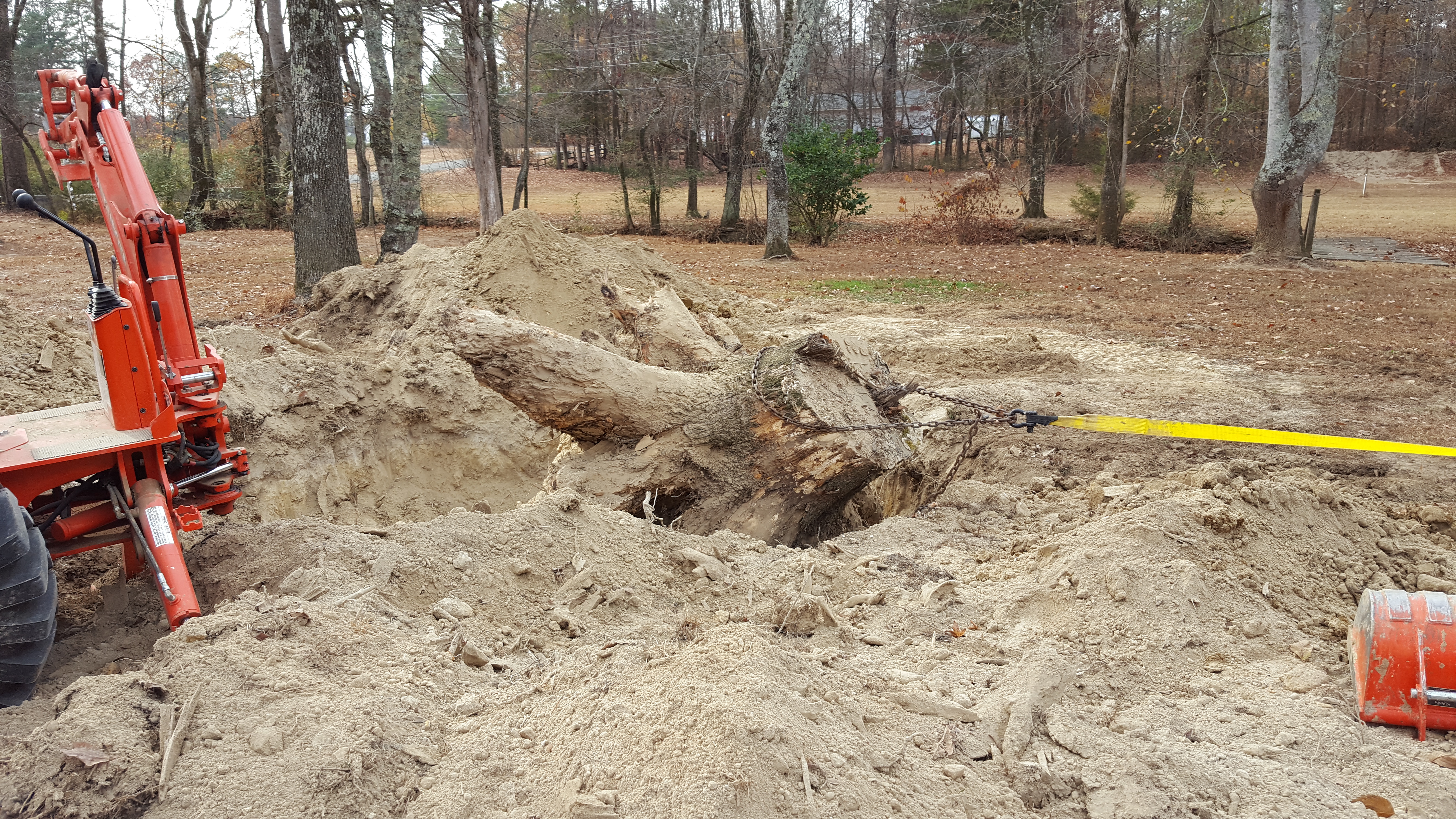

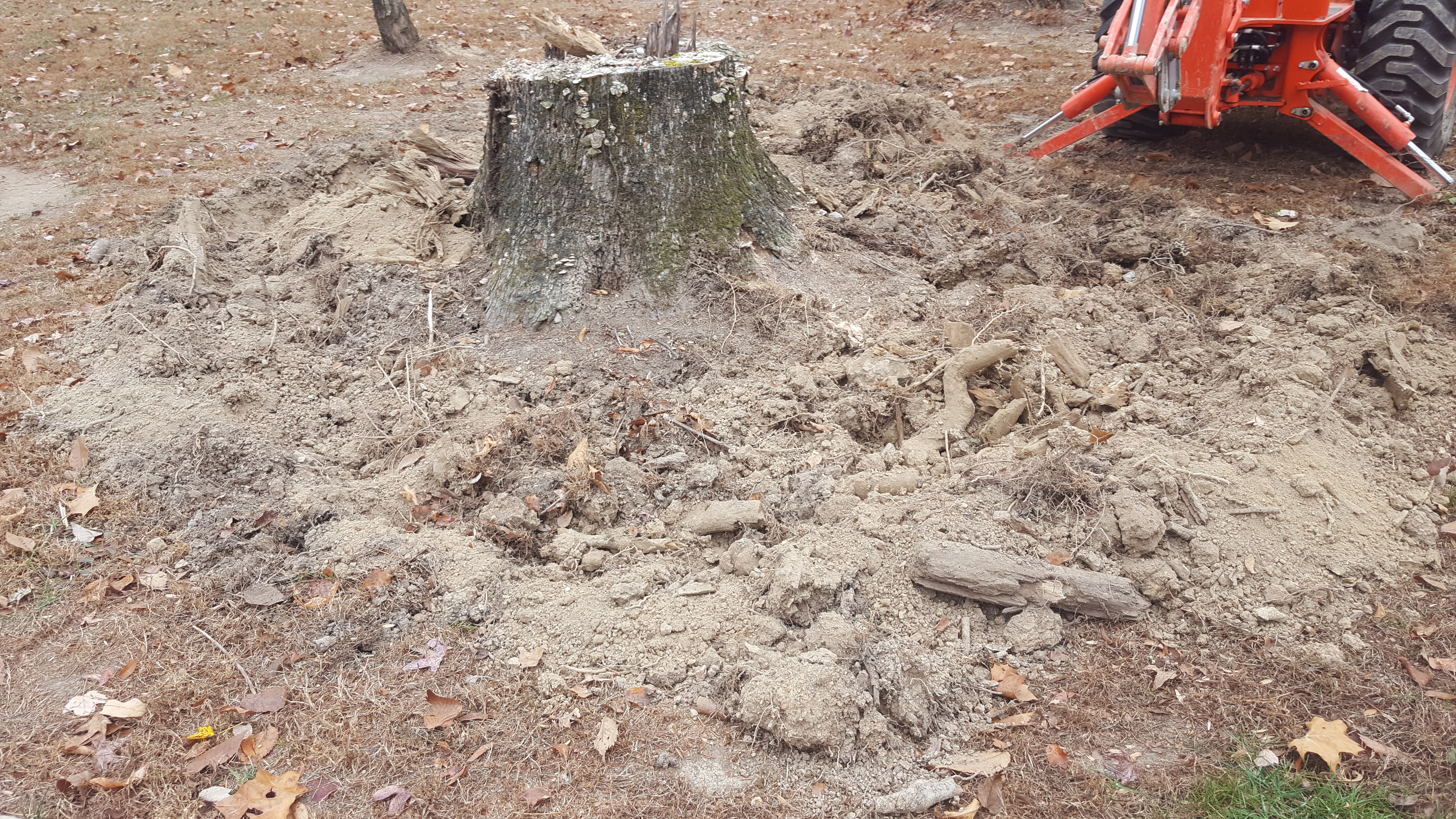

Got tired of mowing around it so i drcided to take it out I used BXpanded's ripper attachment to cut through the roots.I had to have a little help from the F250 to get it out of the hole. 1480290459516.jpg1480290477987.jpg1480290494827.jpg1480290520587.jpg1480290547337.jpg1480290568127.jpg1480290585687.jpg1480290608497.jpg1480290624557.jpg

Not for sure how long.I worked on and off for 3 days.Probably about 6 hours total.Biggest problem was the roots going straight down under the stump.I couldn't reach with the hoe so I had to dig the dirt out from around them with the ripper and use the saw to cut them.
