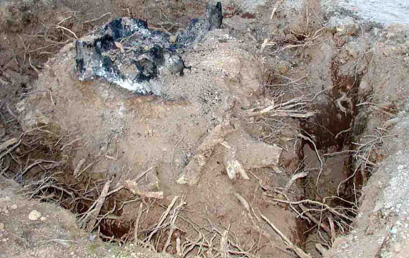

We had a pair of black oak trees growing out of one stump (a fire here about 50 years ago burned down everything and the oaks seem to grow back in rings around the old stumps). One of the trees developed the only mistletoe we've got, and the trees were in a path where we wanted to reroute a driveway turnaround. We cut the trees off at about 10' tall to leave a lever to be able to tip out the roots. With a 8,000 lb winch on the pickup, the one tree broke off without moving the stump. After cutting the other tree off just above the ground (big mistake), I drilled a couple of dozen holes and filled them with potasium nitrate and waited six months or so to burn out the stump. The burning did not progress past the top, and the stump needed to go, so having just got the BX23 in January, I spent approximately 11 hours with the backhoe and FEL digging down approximatley 4' all around the stump. This was my first BH experience, and the time was mostly spent learning technique. A dozen or so roots were too big to break, So I sawed through those. There do not seem to be any more roots, and from roots removed years ago by a cat, the black oaks don't seem to have a big vertical tap root.
Pushing and pulling on the stump's top with the BH had absolutely no effect (except on the BX23). I got out the trusty F250 pickup and hooked a tiedown chain to the trailer hitch and banged stump three times with the chain positioned to tip it out in two directions and to twist it. Only one tiping attempt moved it, and only about 4", according to my wife. It settled right back down.
For scale, the wood part of the stump is approximately 4' across, even though the two tree remnants are lots smaller.
Stump 1. Bitseeker 0.
What to do next? Dynamite? Hire a CAT? Give up the plan?

If bringing in bigger equipment is not an option I would dig a ramp on one side. With the way your hole is dug so close to the stump it has to be lifted out which is to much for our small tractors. Dig a long wide ramp that will let you scrape out some of the dirt under the stump and pull it towards you. Pull as much as you can out and you should be able to lever the stump towards you.

My procedure was slightly different in that I was digging with the FEL and as I exposed a root, I would loosely wrap a chain around the root, attach it to the tractor's tow hook and break the root. The loose chain would saw and scrape the root just before it would tighten and then the root would break. I would then lift the stump, from underneath, with the FEL. That helped expose other roots, where the root breaking procedure was repeated. After each root broke, the stump could be lifted a little higher with the FEL.

I would have to agree with everyone that is suggesting larger equipment. However, if you are stubborn (like me) /forums/images/graemlins/smirk.gif, I have used the ramp technique several times. There is no way that you can lift a stump like that with a BX23. The only way to move them is by dragging. I have done like you did, cut a deep trench around the stump, breaking all the roots. Then cut a ramp down below the stump. At this point you should be able to tip it over onto the ramp. I have used a high pressure hose to blow away the dirt from the root ball. Then you "might" be able to rap a chain around it and pull it out of the hole. Then you "might" be able to push it to it's "final resting place". It's a lot of hard work, but if seat time is what you're after........ /forums/images/graemlins/grin.gif

Thanks to everyone for the suggestions. Before I hire a solution, may try removing dirt and rocks from the root ball. I have water nearby and a fair-sized pressure washer. After washing, I will probably have to wait a few days for the water to subside.
We have excess firewood from a mild winter, so after seeing what the stump looks like with some dirt and rocks removed, and the water gone, I may stack firewood around the stump and try to burn it before the summer burn restrictions.
