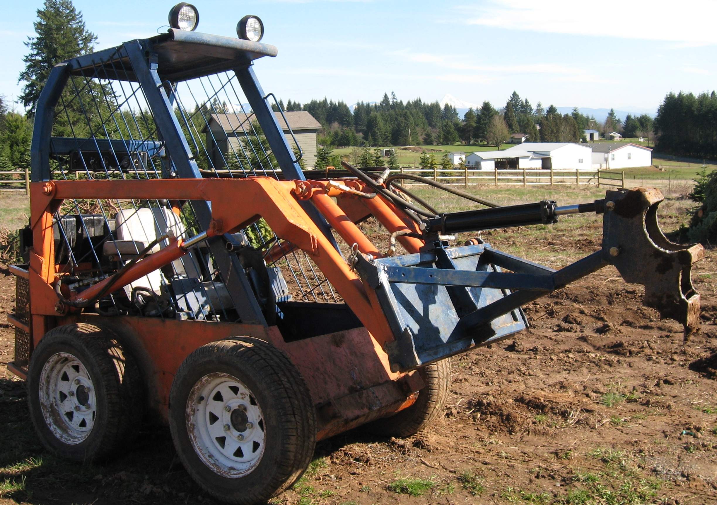

Here's a picture of the stump hoe I built to get x-mas tree stumps up quickly. As discussed in a prior thread, a track hoe with a thumb is ideal, but expensive to rent every year. I tried a single tooth ripper, which did a good job cutting the roots but had trouble grabbing the stump itself. This hoe works good for me with my small skid steer. I dont have enough power (or weight) to just yank the stump out, so I do a little digging around first. I used a 5" cadplans bucket, modified with most of the back cut out, as well as some of the sides.

That looks pretty cool. How well does it work? Do you go back later with a bucket to pick up the stumps?
   / Stump hoe for x-mas tree stumps
We come back and drag the stumps (by hand) to a burn pile. Quicker and easier than using equipment, especially with the field all torn up and muddy. I think it works pretty good, although I'm still a little too slow as I get used to the controls, I had to cut away a bunch of the bucket to keep my clay dirt from sticking... after my first year/first thousand stumps, I should have it going pretty fast ;-)

get much traction with those car tires?
i would have thought a least a small set of mud tires would be better....
hey now, lets not be insulting the skid steer - I'll put my homemade skid steer up against most of the others I've seen ;-)
And, my tire set up works pretty good - in the summer and on pavement, the tires work great. In the mud, I put some cheap snow chains on, sometimes just the back, or sometimes front and back, depending..... works for me......

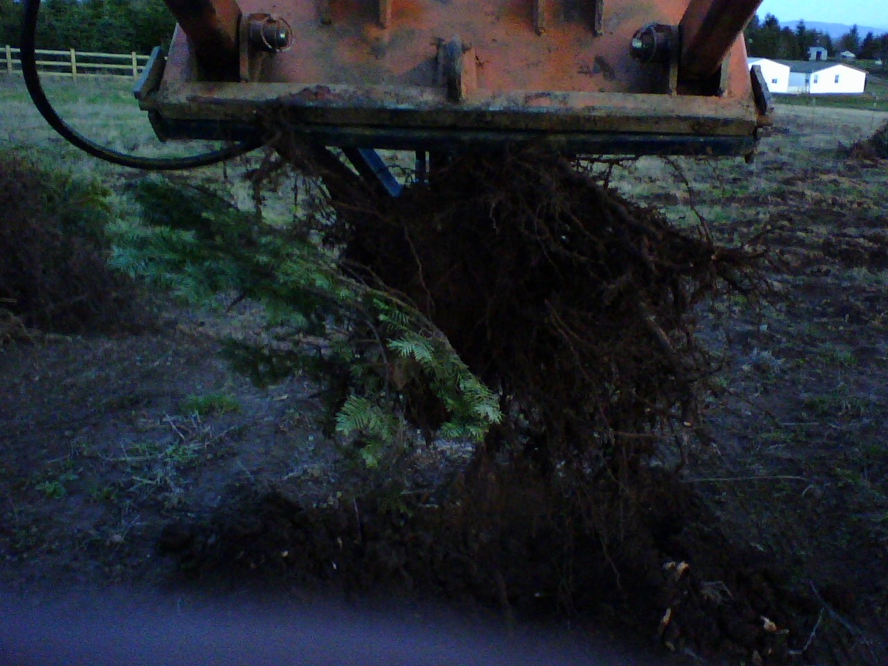

Alan, I use it like a backhoe. I come over the top/back of the stump, usually slightly off to one side or the other. Take a scoop on one side to loosen the roots, take a scoop on the other side to loosen the roots, then try to get a good deep scoop directly under the main stump, work the bucket back and forth to break everything loose, and lift. I cut out the back of the bucket so I don't have to keep emptying it, and I get more force than the normal backhoe because its so narrow, and I went with a larger hydraulic cylinder. My attempts at action shots didn't come out very well, and (fortunatly) I'm out of stumps for the year.....
