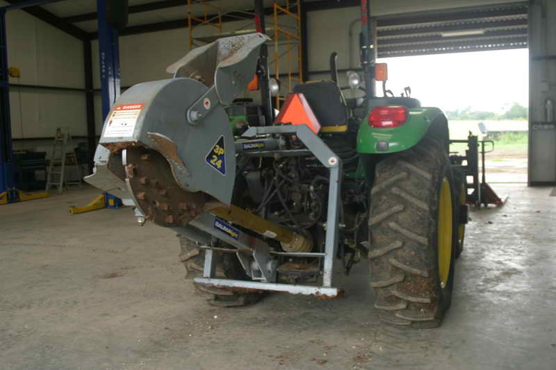

I cut down two old large oak trees that had been dead for a while and needed to grind the stumps. Earlier this year, I purchase a used stump grinder for $2k that I don't think had ever been used. Its's a Bumalight 3P 24 which is a 3 point mounted stump grinder with a 24 inch wheel and replaceable carbide teeth. The PTO drives the wheel and two rear SCVs control the up/down and side-to-side movement. The 3 point lift is used to raise the grinder when you are moving it around. Otherwise, it rests on the ground when you are grinding away.

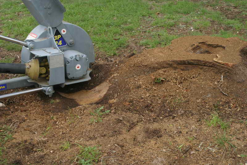

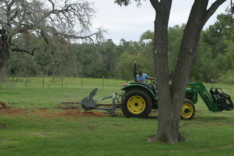

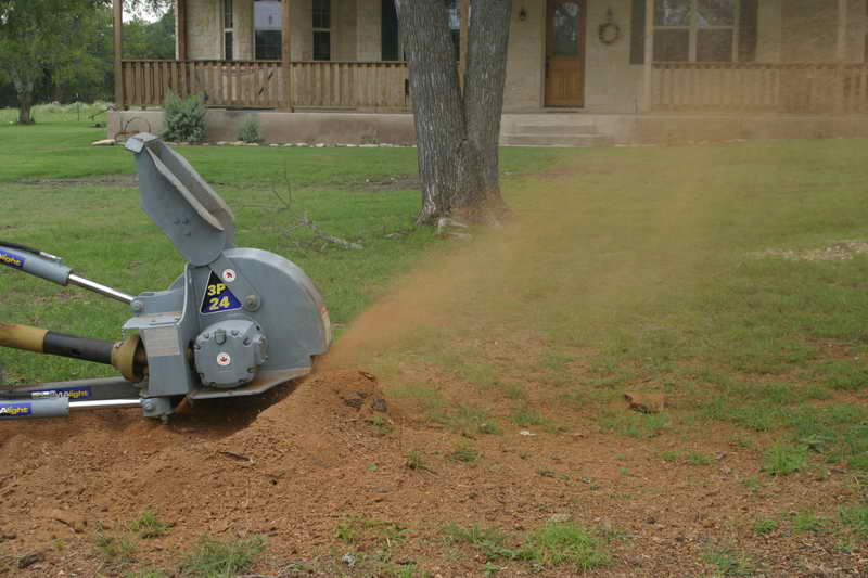

I can take about a 1 inch deep bite each pass and I get a pretty fine saw dust about like you get from a chain saw. The swing is about 45 degrees to each side which allows me to cover about 30 to 40 inches of swing in a single pass.
I ground the stumps to about six inches below ground level. Total time for both stumps was just less than two hours including cleaning up and spreading the saw dust out. It started to rain just as I finished up so the saw dust looks really dark in the final two pictures.
