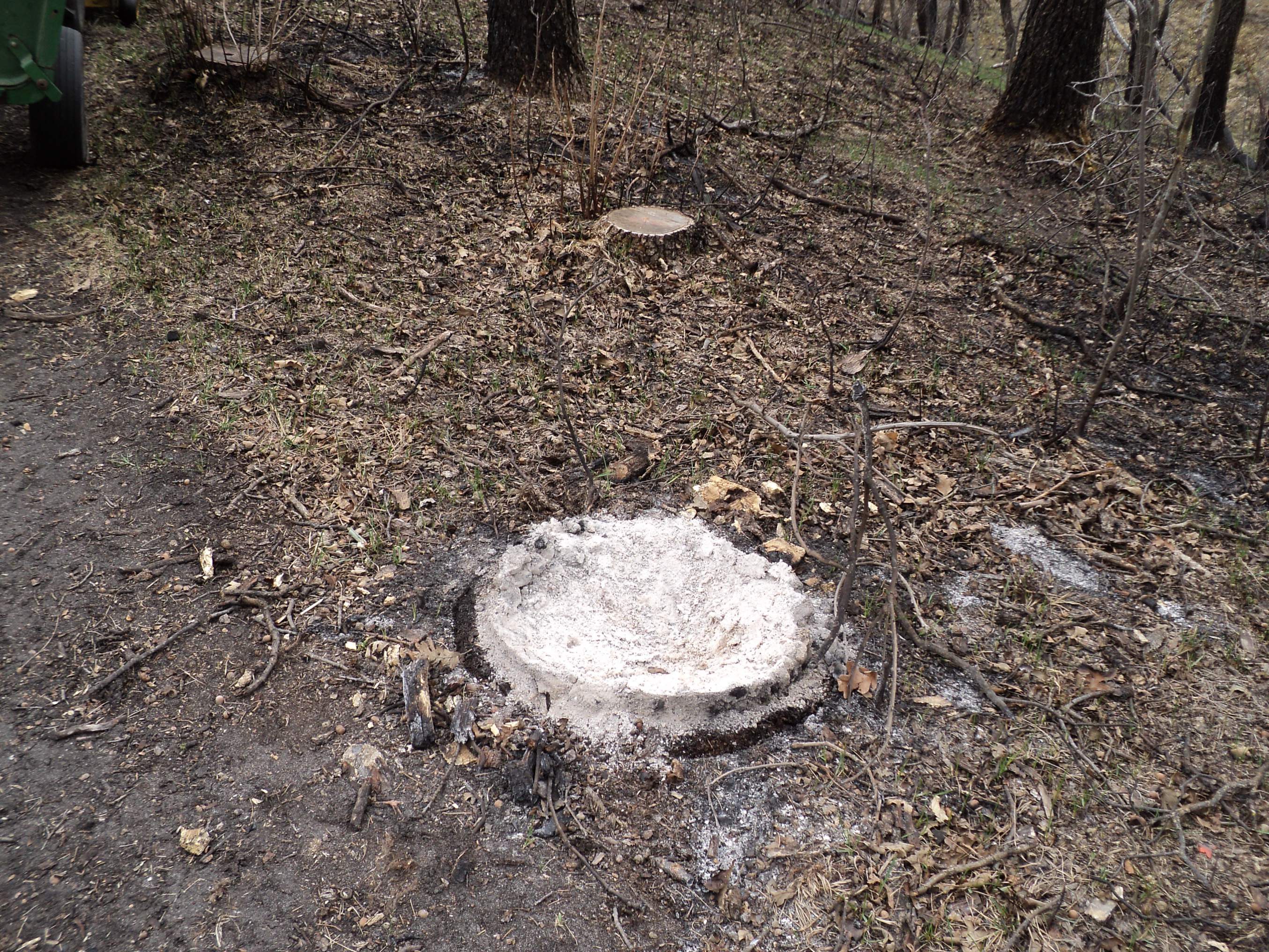

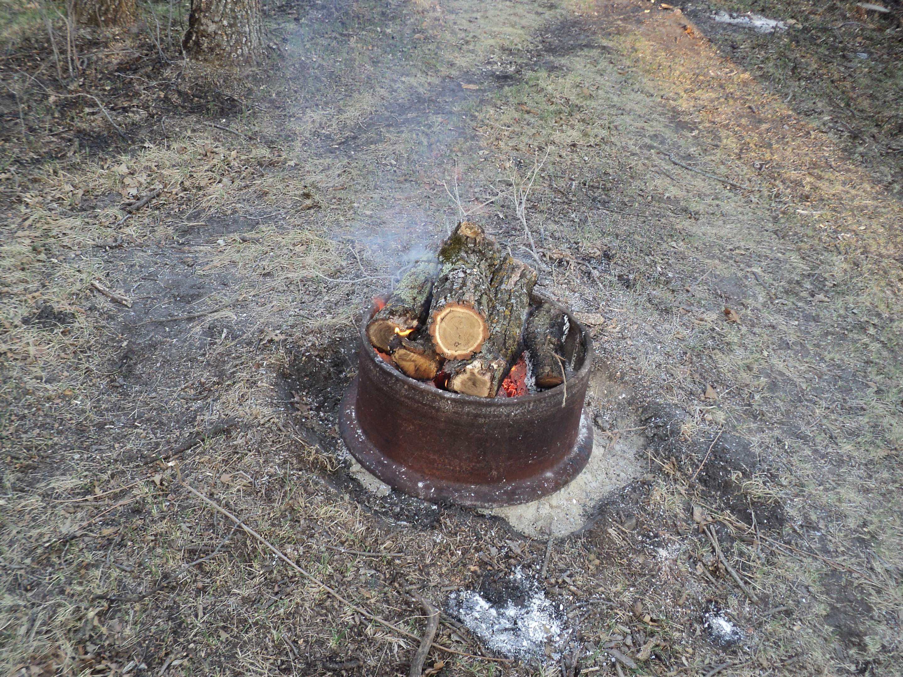

Here is my "stump grinder". A Dayton rim with 10# of charcoal placed over the stump., after I drill holes in it with a cordless drill and dump diesel on it.
If the stump is good and dry, it burns out below ground level. I feed the fire with oak or ash chunks.
Repeat application may be needed for wet or greenstumps.
I paid $15 for the rim.
